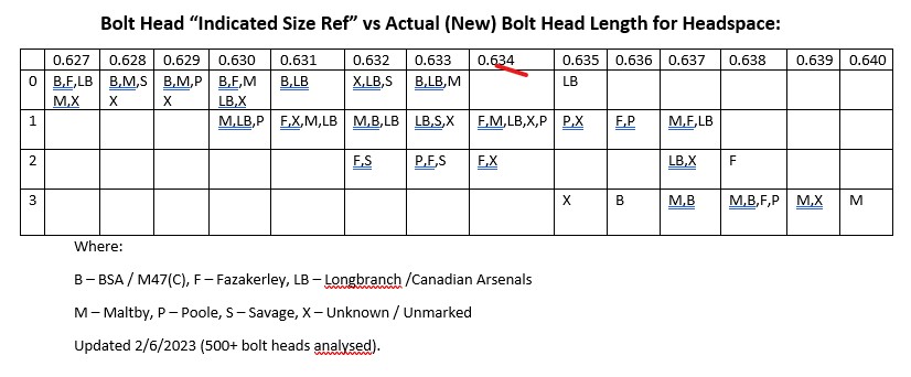

    Another No4 / 5 LE Bolt Head Cross Reference
    Ive been brewing this table in my own material for some time. It had a bigger update recently. Doing a quick search I found AdE beat this by over a decade - am trying to add, not complete / recreate! Sharing data for the good of the whole - this version layers in maker factory marks (and eliminates blank entries). More Enfield data and measurements brewing.. please exercise "trigger control" - LoL
Name:	Bolt Data 2-6-2023.jpg‎

    Excellent!!!
