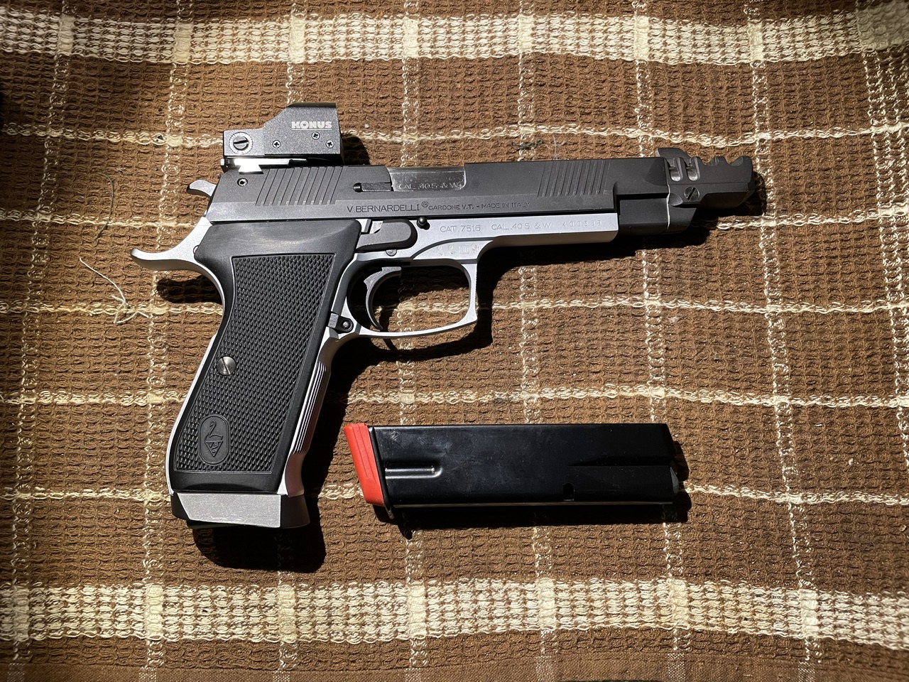

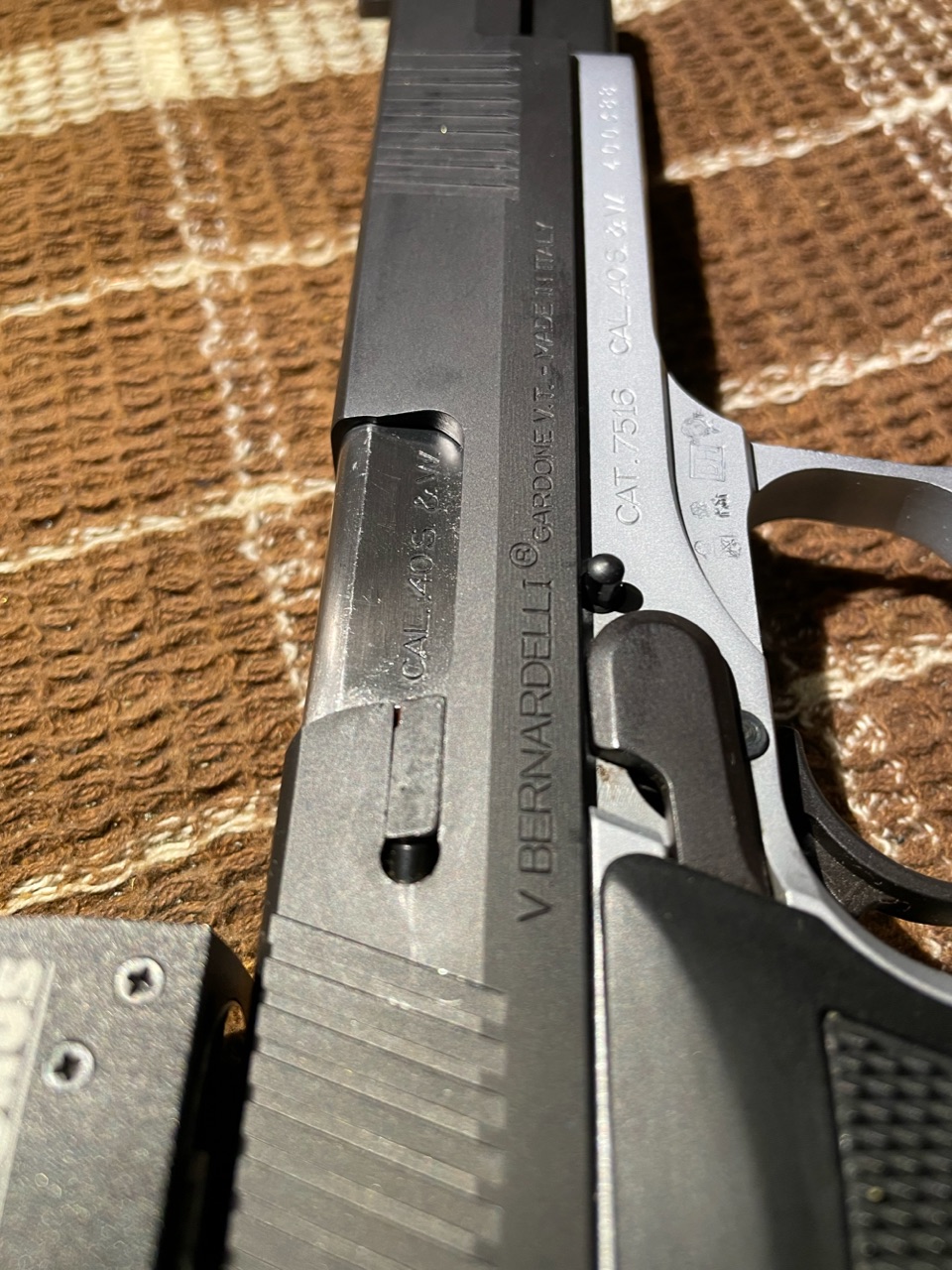

    Finally… I could drive to the gun shop and pick up the new toy.
    Lovely!
    It is like new, though it is 30 years old,and has a wonderful custom mount for the red dot. The original LTA adjustable rear sight is also there.
    Here a few pictures.
    In the “family portrait”, we have:
    P-One im 9x21 on top
    The new Practical in .40 S&W
    The outrageously fantastic Practical Elite, in 9x21.

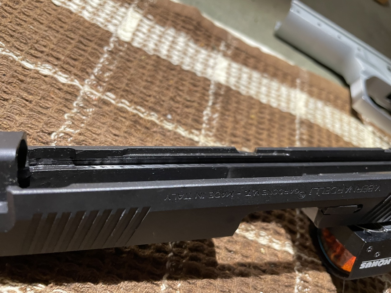

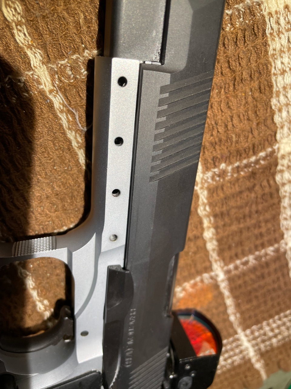

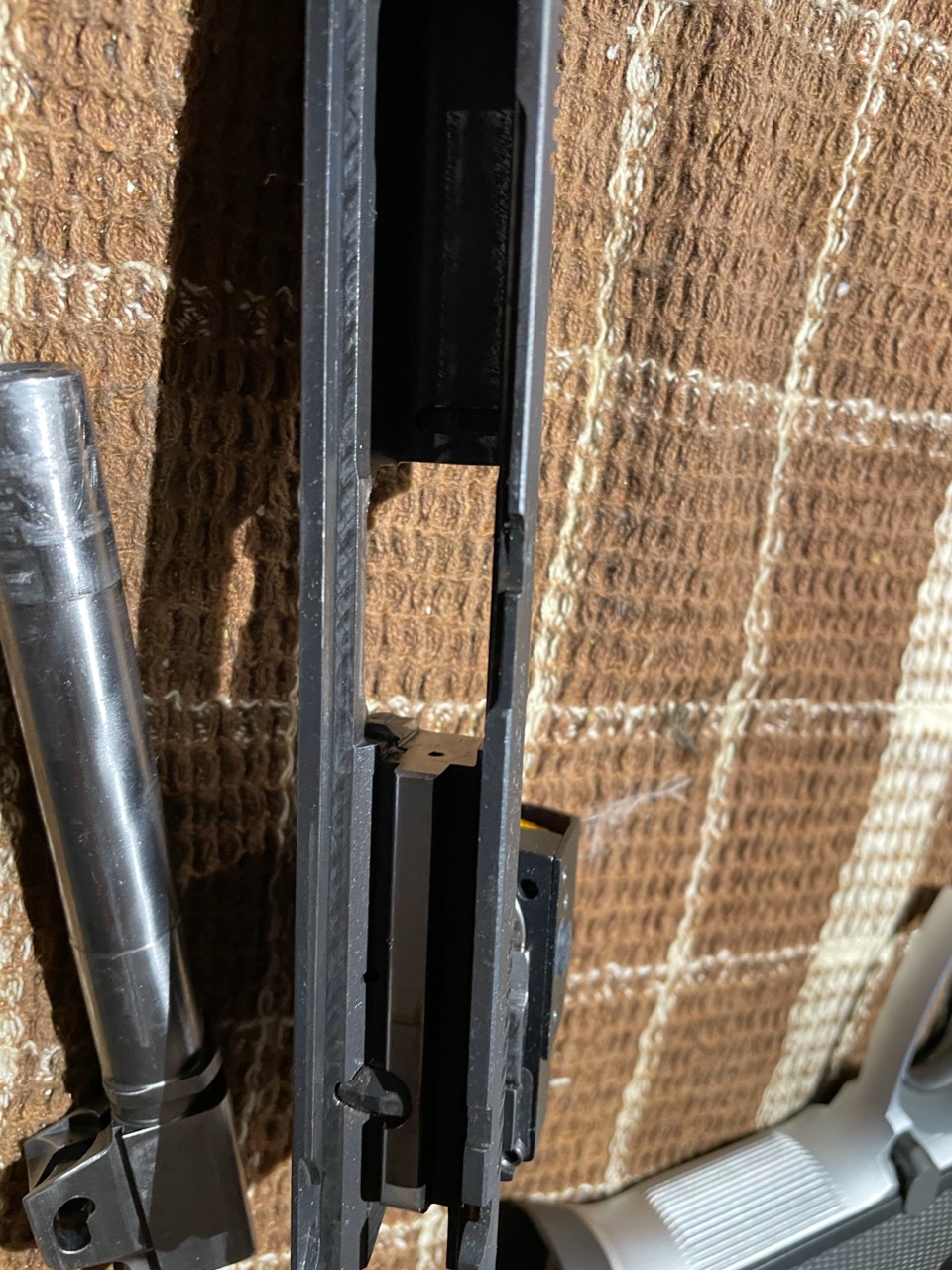

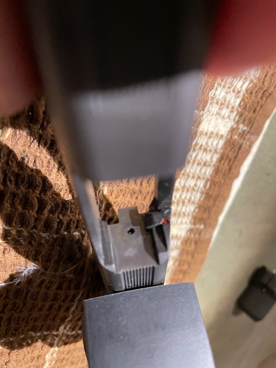

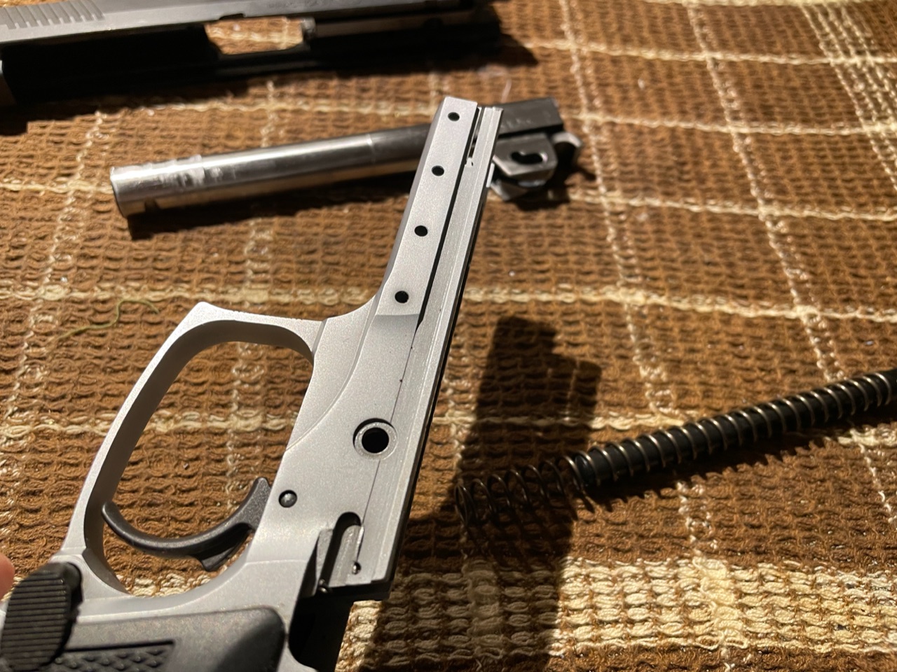

    Horrendous experience my first rounds with the new beast.
    Every single round, she cycled perfectly, but the trigger just wouldn't engage again. Was being free to be pulled back, but did not work.
    It was slightly "scraping" at times.
    A couple times, the hammer fell, but no shot, since the striker safety was not engaged by the "nose" on the transfer bar.
    If I brought the slide back by 1-2 mm, the transfer bar would click and engage the normal position it always should reach to allow the trigger mechanism to work.
    And the round would fire without issues.
    If I pressed the trigger and manually slid the slide, everything 100% ok.

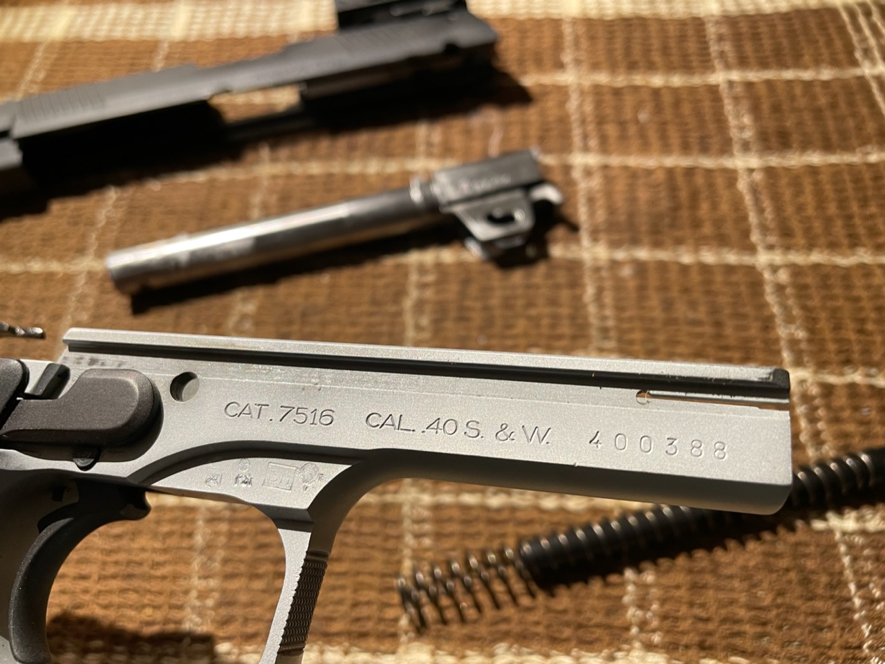

    So, I shot with the other gats and went back home to analyse the problem.
    I took the gun apart, checked everything.
    Lubed everything, tested with operating the slide manually. Everything ok, never any problem.
    Then, waking up finally, I operated the slide keeping the trigger pressed. There came the problem.
    But everything was ok in the chain of the trigger/hammer...
    So, take down the gat again, damn...
    Transfer bar is ok. In the right place, with the right angle. No strange things.
    100% like my P-One and my Practical Elite.
    Until I noticed that the trigger adjustment screw (it is not a real screw, it is with recessed hex and no head. I just don't get the right word now) looked pretty high on the trigger mechanism when looking from the inside. Unscrewed a turn and... Solved.
    I must admit that I started being a tad upset, but finding the solution made my day.
    I can't wait until tomorrow to test it again, shooting a full magazine without issues.
