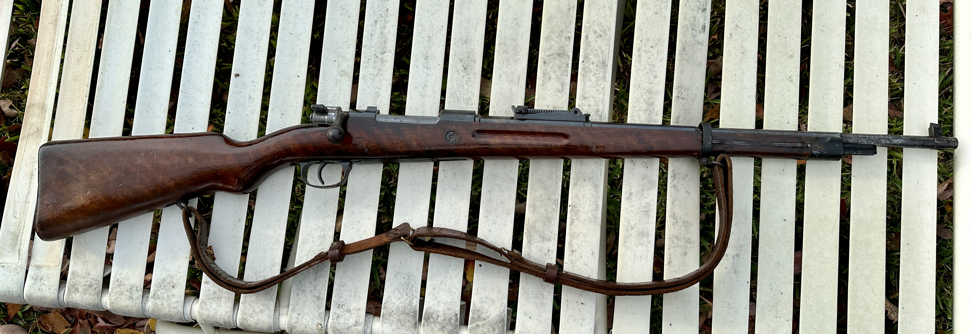

    My cousin has now handed me the FN model 1935 Peruvianicon short rifle (Mauser) his dad purchased from the government at the same time he got the inland carbine back in 1968. I’m creating a new post for it.
