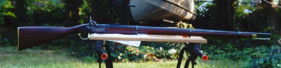

    1864 Springfield/lube job?
    I just picked up a cut down Springfield Rifle Musket for 60 bucks. Excellent bore, everything else was nice except for the poor rifle getting cut down. After replacing the front site I have $100.00 in the rifle. I rubbed Lyman's "Black Gold" lube into the cannalures and shot a half dozen rounds. All indications are that this will be a fun rifle to shoot as well as a deadly weapon to hunt with. I've been shooting muskets for thirty years. The minnieball/rifle is a new animal to me.
    How do you rifled musket shooters lube your minnieballs?
    Thanks,
    Mark

    Back to the top of the question- I also have a "cut down" 1864 Springfield who's barrel is cut to 34" and the forearm of the stock cut to a more modern length stopping (with brass cup) 23" from the muzzle. Front sight is an imperceptible soldered bump and the rear sight is missing with it's Dove tail filled in with a contoured slug.
    The story I got was-- Many of these were turned into "fowling pieces" to supply the west bound crowd with a meat gun. The bores being machined to smooth bore. The stock appears to be stained oak with no marks, names or anything. Rumor has it they were forsale in the wards catalog as late as 1901. If anyone has the real facts- please post.
