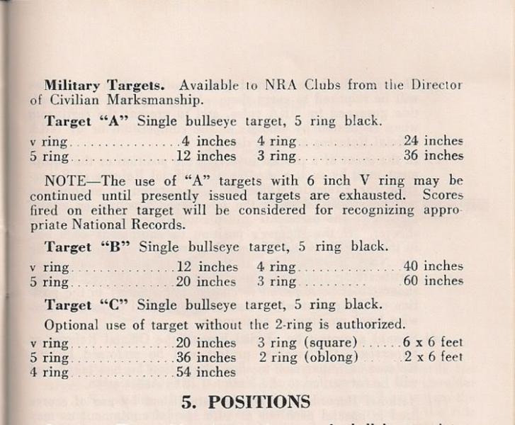

    After WW II, the bull was increased to 12" and the 6" V ring was added. From the 1954 Rule Book:
    In 1960, the V ring was made smaller. From the 1961 Rule Book:
