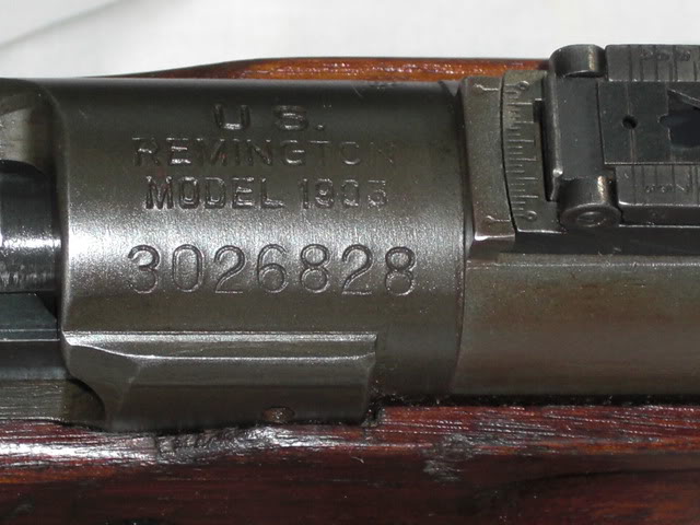

    Then I looked at the receiver:
    U.S.
    Remington
    Model 1903

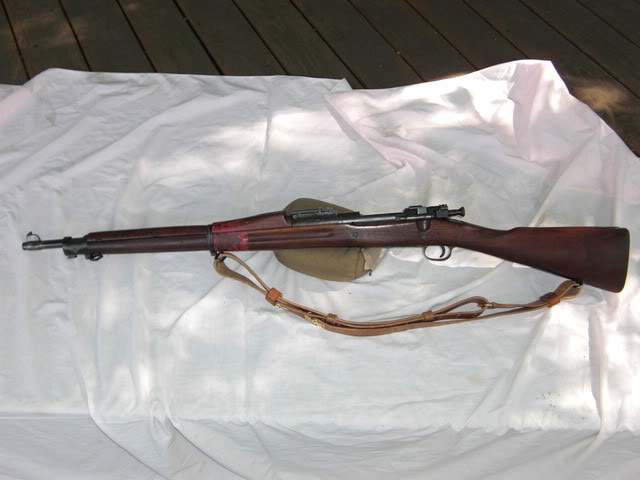

    Some additional pics (I added the sling):
    Receiver.

    This "302" is without the lightning cuts on the rear sight base, but it's housed in a finger grasping-groove stock.
    All Remington "R"s are in the correct location and of the correct size, as far as I can tell. This includes the bolt handle, the right rear side of the trigger guard and the various parts of the rear sight, and elsewhere. Some "R"s are harder to see than others due to wearing, but they are there ...
    Rear tang of receiver is not drilled through ...
    Cartouches are also hard to see, faded or worn, but you can make them out.
    Boxed "RLB" cartouche:
    Mysterous "43" ahead of trigger guard, with some other barely discernable markings.
    Britishicon proofing marks on receiver.
    Also, a question for RTL or other 1903 experts: is the extractor on the Remington 1903s below the 305 serial # range supposed to have an "R" stamped on it (or some other marking) identifying it as a Rem as opposed to a RIA or Springfield extractor? If so, where is it supposed to be located? Thanks.

    Hello Nick, I'm a home guard memorabilia collector. This is just a possibility. The majority of U.S. rifles sent to the U.K. and adapted for home guard use were P-17 U.S. Enfields in 30-06. The red paint was required so the home guard volunteers wouldn't try to load .303 into 30-06 chambered weapons. Most just brushed it on with little effeort for a neat job. Several thousand Springfields were also sent. The red band painted at the handguard is a fair clue. Is there anything else painted on the stock? Rarely, some home guard units would also paint .30 cal or 30-06 or cal 30-06 on the butt stock - usually in white paint.
    *Just saw the pictures. I think the Britishicon crown marking is also a supporting clue. The 12/1941 date barrel throws me though. It's very late. Most of the U.S. goods showed up in 1941. Was it rebarreled in the U.K. later? I'm puzzled.
    Just checked - BNP under a crown is Birmingham nitro proof.

    My friend, you hit the jackpot! Assuming you paid the $500 mentioned, you got it for at least 1/3 or less the going rate, probably less. Yous was one that was sent to the UK in 1942. The Britishicon proof marks identify it as one that was imported back to the US, probably in the 1960s. The markings look a little worn, but you have a (based on previous sales of these rifles) a $1500-2000 rifle!
    If you want to find out more about these rifles, read the article that John Beardicon and I wrote in the July/August issue of "Man at Arms" Magazine.
    I have #3,024,801 and the markings are very similar. However, it was obtained earlier, so the proof markings on te FRSB are missing.

    The "R" on early Remington extractors is located on the bottom rear corner.
    Hope this helps. And thanks for sharing! You have a splendid rifle!

    Nick's rifle would not be a "Red Star" Remington. "Red Star" Remingtons do not have Britishicon proof marks.

    I agree with John - as I said in my earlier post this rifle was probably one of those imported into this country from the UKicon in the 1960s and sold through various surplus outlets.
