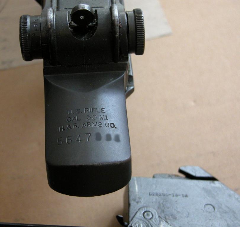

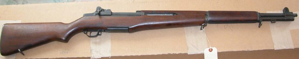

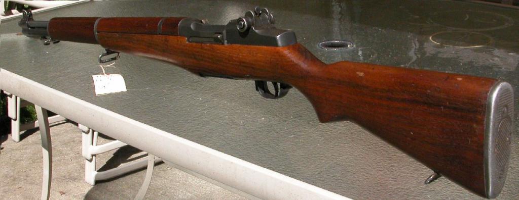

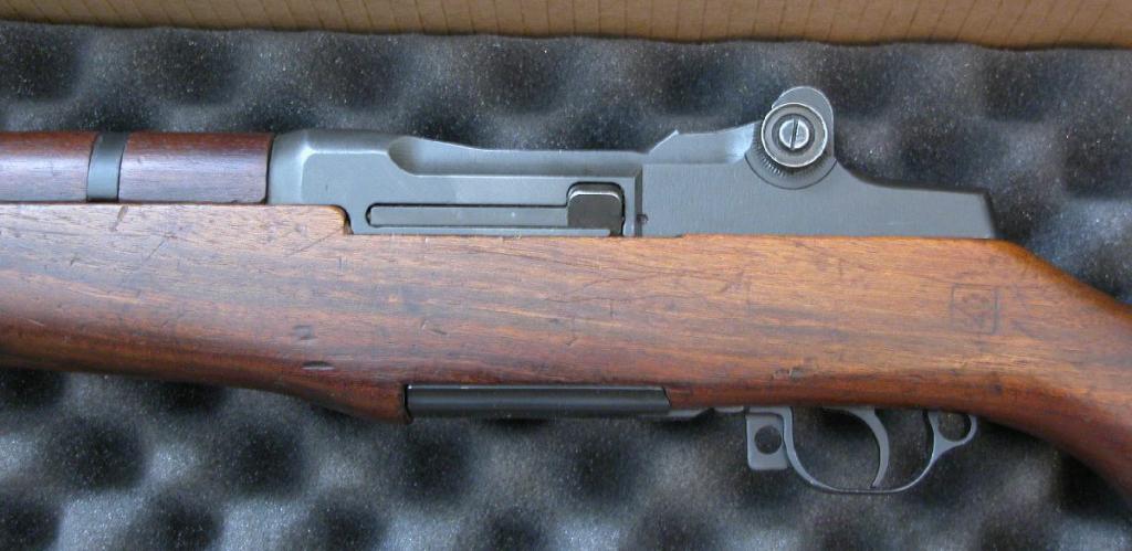

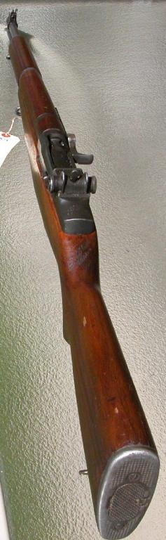

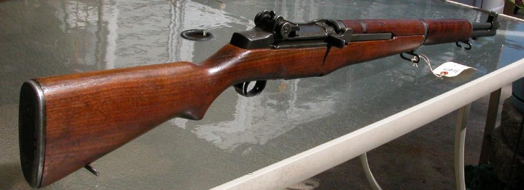

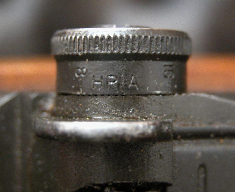

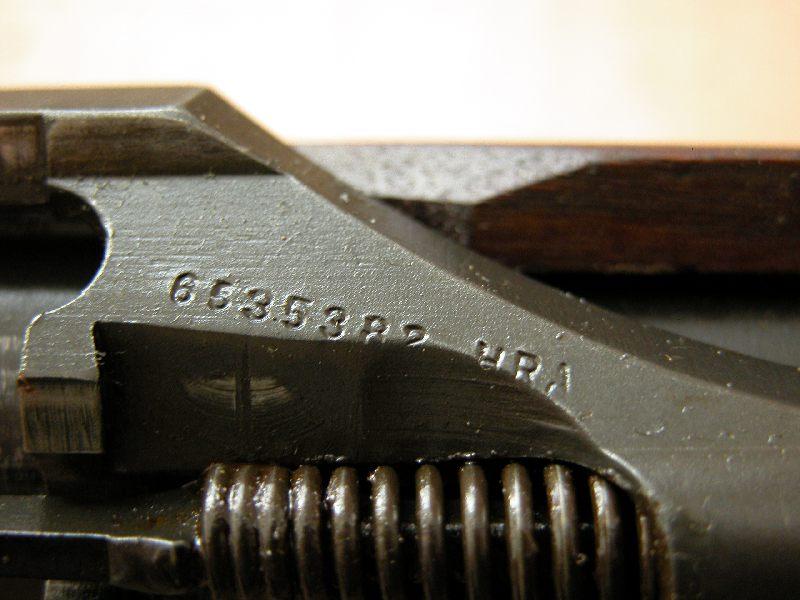

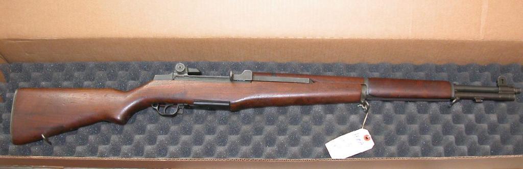

    Just receive my "new to me"
    CMPicon HRA SG Garandicon
    S/N 564xxxx

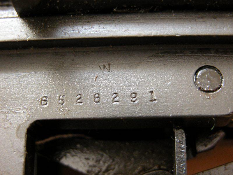

    Receiver side marked " 6528291 " And a " W. " above that
    Oprod marked " 6535382 HRA "

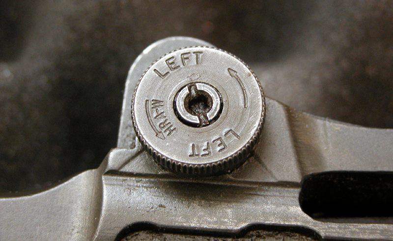

    Rear sight windage marked " HRA-W "
    Rear sight elevatation marked " HRA "

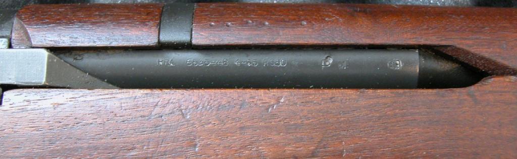

    Barrel marked " HRA 6535448 4-55 RS50 "

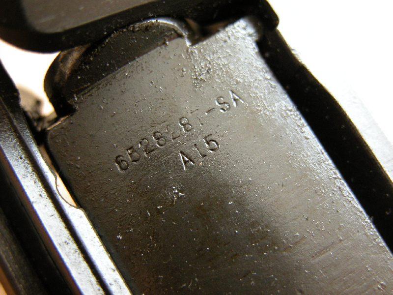

    Bolt marked " 6528287-SA " " A15 " heat lot.

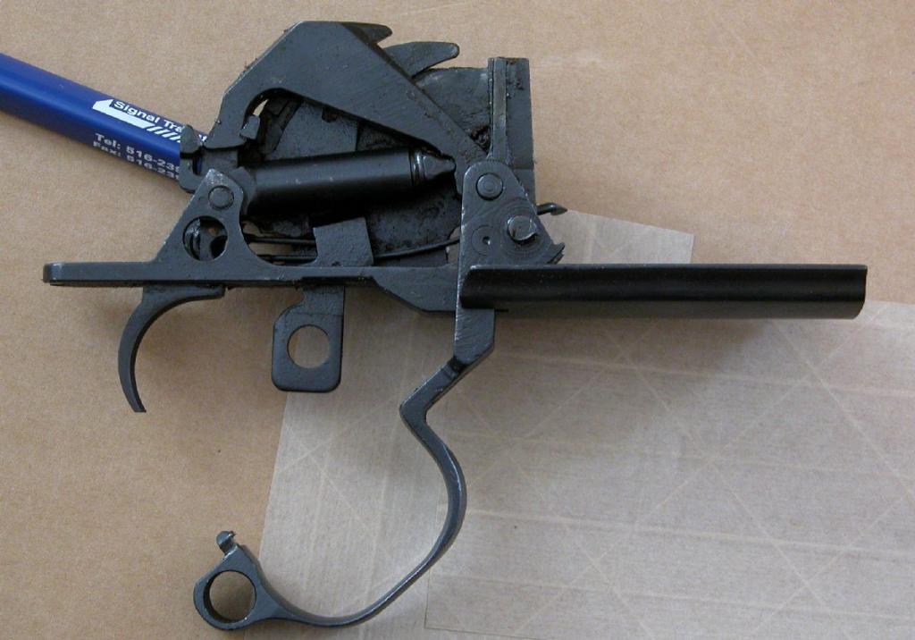

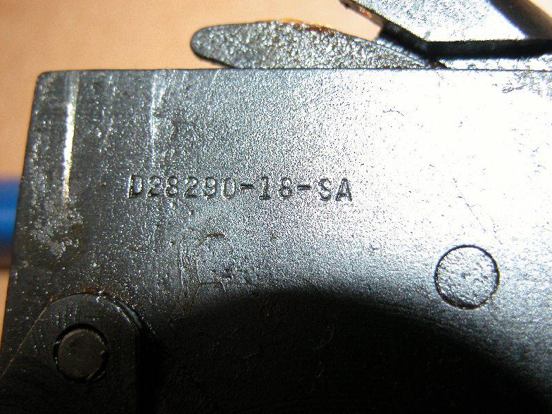

    Trigger marked " D28290-18-SA "

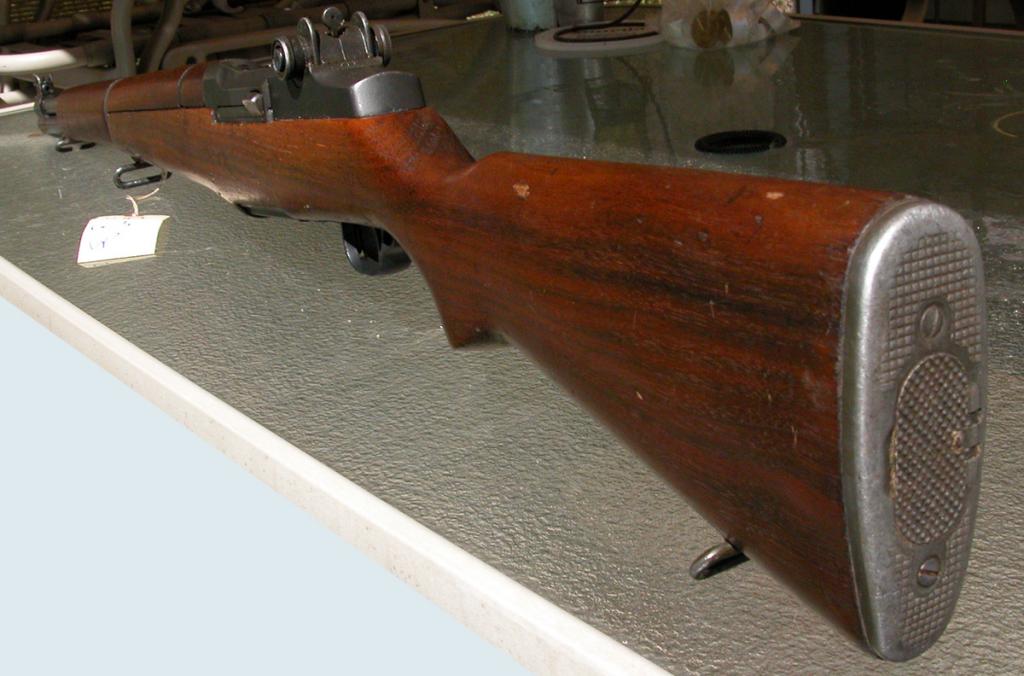

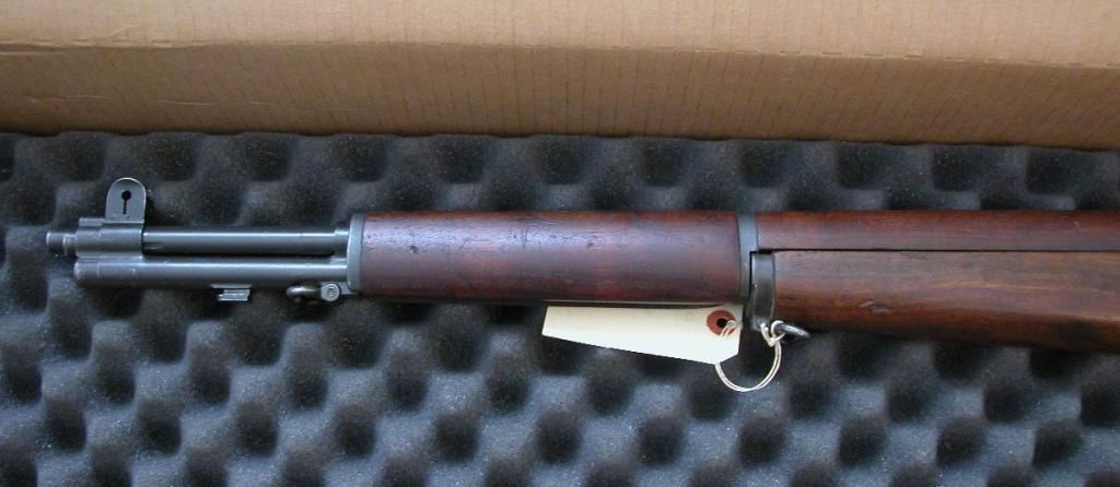

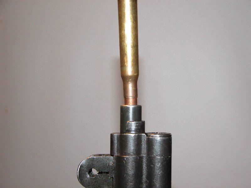

    Front handguard is real tight, no slop - no movement what so ever.
    As I understand....not good I assume.
    Needs some room?

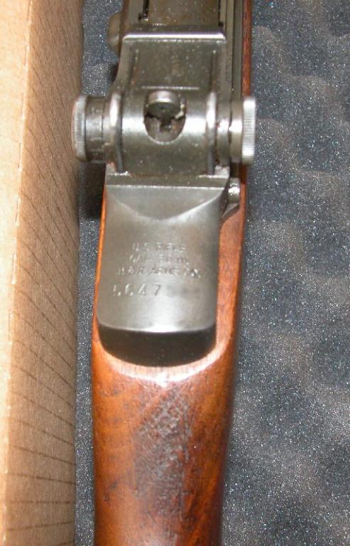

    Sights feel tight and move well.

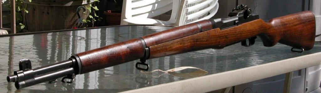

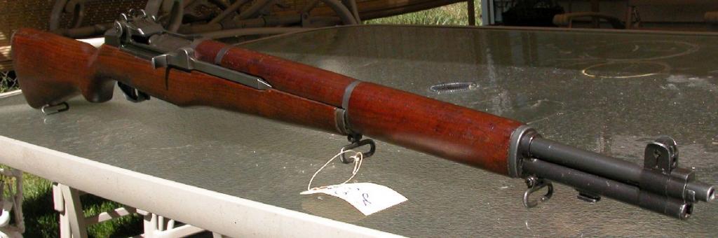

    Stock feels nice, but greasy!
    Lots of grease in every corner.
    Lots of character and handling marks.
    I like the grain.

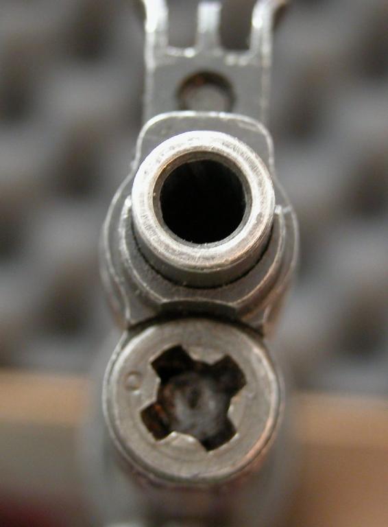

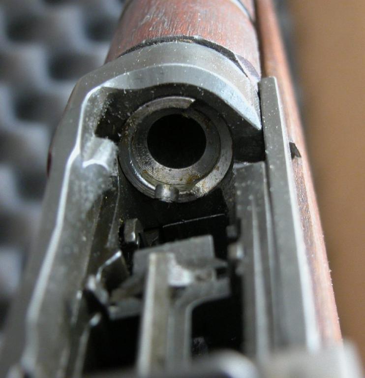

    Barrel appears dirty, but very defined rifling and looks like it will clean up well. Don't see any pitting in it.

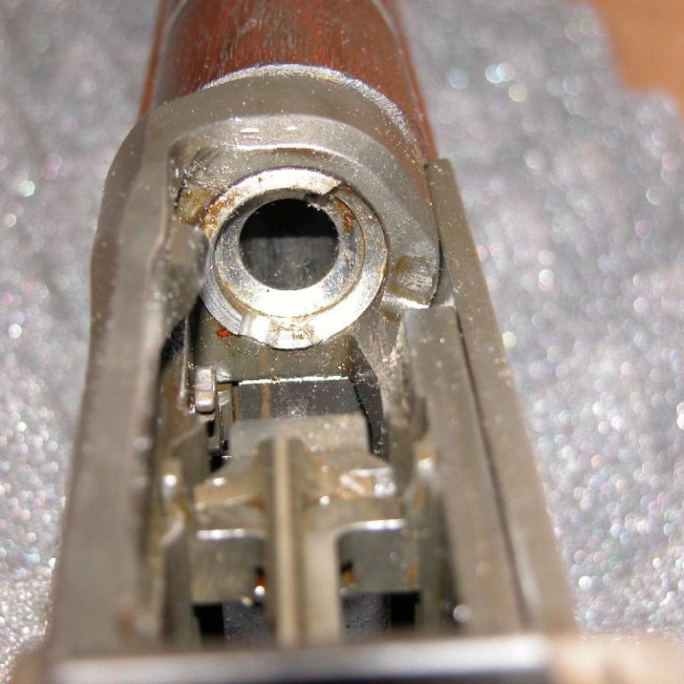

    The charge handle on the oprod has some minor wear from use, some shiny metal starting to show, feels polished, no rust no pits anywhere.
    All the finish matches.
    Seems to be an all correct rifle , but for the bolt and trigger assy.

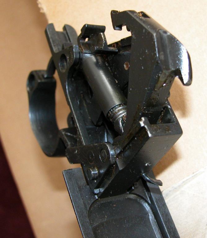

    The trigger assy shows light wear, but some on the trigger and hammer.
    Otherwise very minty.
    The trigger assy threw me. (again a newbee learning ) I thought the milled trigger guards from SA were original early 45 and before SA WWII production.
    SA bolt, looking up the numbers and heat lot, the bolt is the right time frame compared to the barrel and appx born on date for the s/n of my HRA.
    But I've been told, nope, HRA parts only should have come in there.
    So , is this maybe a CMP change out?
    Doesn't seem like the Greeks would put in a 44/45 trigger assy, and putting in a mid 50's bolt, on a rifle that looks slightly worn metal wise.
    Why would someone change out the bolt and trigger assy... except for CMP to build a minty correct HRA?
    I'm very happy with it. I'll get her cleaned up and an official physical by Orion 7, then down the range.
    Thanks for looking / and educating me..

    Very nice pictures... Thanks...

    Man the CMPicon really sent you a nice SG! Judging from your excellent pictures, there's nothing about that rifle not to like. It should not be so difficult for you to change out the few parts needed to make it all correct. All you need now is a can of HXP and some quality time at the range! Sincerely. BruceV.

    S.A. started using Stamped trigger guards in Mid 1944 .... though milled guards were also used into late 1944. All HRA's should have stamped guards.

    jayclay, I'm doing a trade with a buddy who wanted the SA bolt and had an original finish HRA correct # bolt for my HRA, and as of now, it seems he's keeping the SA bolt for a project. Sorry.
    Devil Dog, so the SA trigger group would be a nice show piece for my 43 SA receiver?
    BruceV, you were right on....
    The gun got a blue ribbon of health by Orion 7.
    Except for the bolt and trigger assy, needed nothing else to be correct.
    Muzzle 1.5 and TE 2.0, all passes and all VG marks, and no work needed.
    Now to get some range time and put a few rounds through it.

    "Devil Dog, so the SA trigger group would be a nice show piece for my 43 SA receiver?"
    Not really...Your trigger housing is from 1945. Your '43 receiver would have a -12 housing. Your Hammer Spring Plunger is from LATE '43

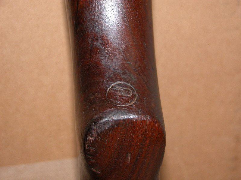

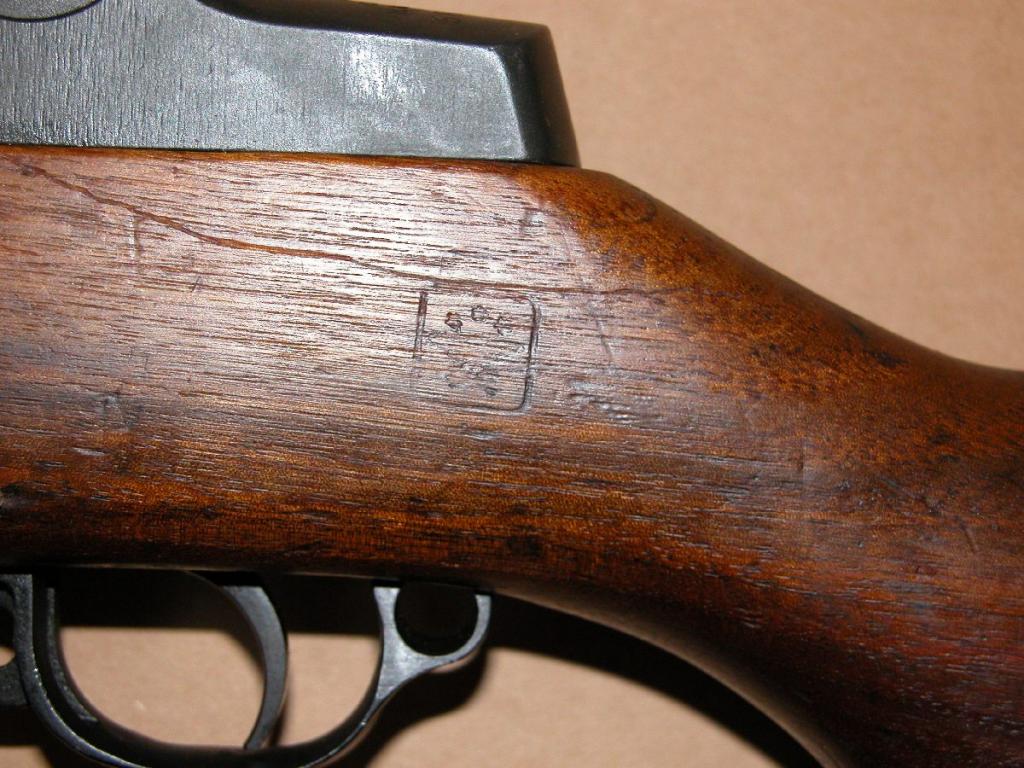

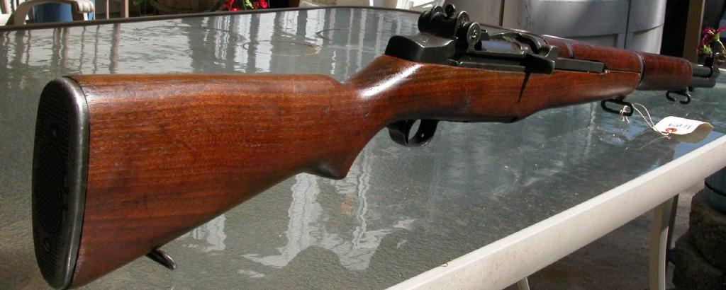

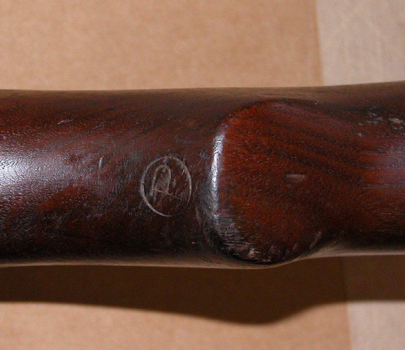

    Your stock does NOT appear to be an HRA, (No HRA porch and serifed "P") however, maybe Tony saw something that we could not see in the pics.

    "Not really...Your trigger housing is from 1945. Your '43 receiver would have a -12 housing. "
    I understand not correct, but I meant just for the looks with milled trigger guard.
    My Orion 7 select grade (with the 43 sa rec/bolt) was built to be a shooter, not correct, hence the stamped trigger guard that is on it.
    "Your stock does NOT appear to be an HRA, (No HRA porch and serifed "P") however, maybe Tony saw something that we could not see in the pics.
    Nice rifle!"
    Thank you.
    Come to think of it we did not address the stock. So I didn't get his comments on it to be honest. We went through all the mechanics of it. And in all fairness to Tony, looking at the P in person, with all the scratches, we at my house are now trying to see the serifed vs non-serife P through the scratches on the stock. But in the picture with the flash, I see the tail on the top of the P.
    I see your point.
    I apperciate the input, I'll ask Tony about it. If so, gives me one more item to get hold of for it I guess.
    Makes me feel better about shooting it with it's present wood, which I do like.
