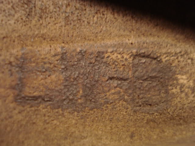

    painter777's Avatar
    Central Michigan
    5,481
    05-23-2025
    10:39 AM
    Here is a picture of a bleached out LW-B marked stock.
    It is damaged on the hi-wood rail. A Type II...or was, repairable but will be time consuming.
    It has just a remnant of the CC left.
    Regards
    Charlie-painter777
