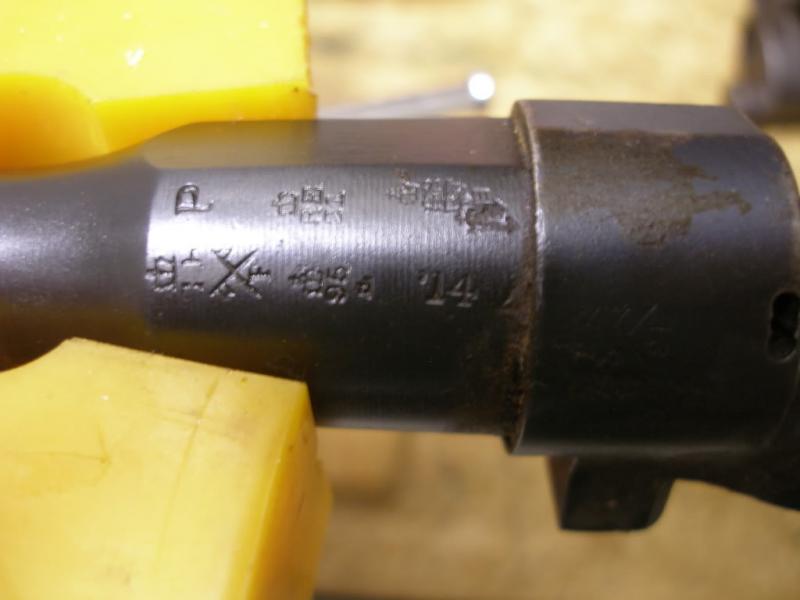

    It's a BSA Co. 1904 ShtLE MkI***, updated to include some MkIII features. Serial is CR1975, putting it in the rifles sent to Ireland. It has a MkI rear sight base, but the middle band on the barrel has the 'III' mark on it, so I'm not sure if it's a true MkI barrel or a MkIII barrel. The barrel has other lined out serial numbers, making me suspect it was altered in the '14 time frame, as there is a '14 mark in the left side. Markings on the underside of the barrel have '44 and '45 stamps, which looks like the last time it went FTR.

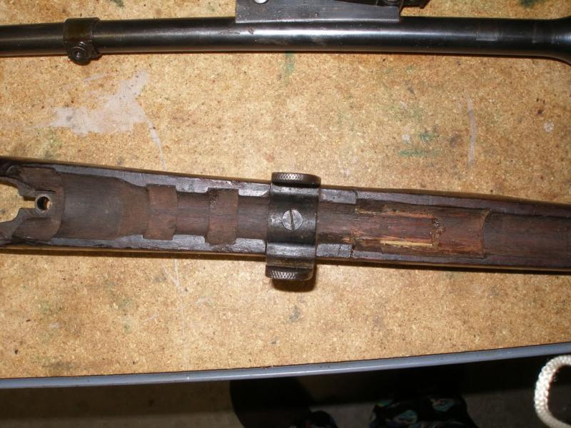

    This must have been someone's restoration project, as the forend was spliced somewhat crudely. It has a MkI rear half, and what appears to be a MkIII front half. The wood at the rear half is not inlet for the charger bridge, so that would have to be MkI, I believe.

    Nice rifle, some very desireable parts on there. You did well.
    The barrel is dated 1914 and it has a MkIII nosecap, Looks to have a MkIII butt as well.
    I have an original Mk1 butt waiting for somthing like this to turn up in NZicon!
    I think i'll be waiting a while.
    A MkIII butt is correct for a Mk1***. The second and third * were added in 1914 at it's last upgrade where it should have got a MkIII butt (for the provision of a butt trap to store oiler and pull through as well as a more secure swivel) and the rear sight bed re machined for MkVII ball trajectories. It should have kept it's own foreend and nosecap. Pretty sure most of the rest of the info you need has already been provided on a couple of other forums.

    Hi I am new to this site and have really enjoyed the informative and insightful comments.I may be wrong but your forend apeers to have been spliced (or at least major repair) just ahead of the sight protectors.This may explain the unusual mixture of mk1 & mk3 features caused by field repairs made far from the ordanance, and supply of "new" replacement parts.

    Welcome, Ripper36! You're not wrong about the splice, but I suspect that its more of an amatuer/low buck restoration, than an in service repair. One never knows, though.
    What's really odd is that the rear piece (SMLE MkIII) is probably older than the front (SMLE MkIII*) as it has the volley sight cut-out at the mid-action(body) area, whilst there's nothing up front. So there's multiple replacement work going on here!
