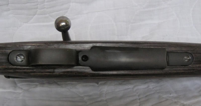

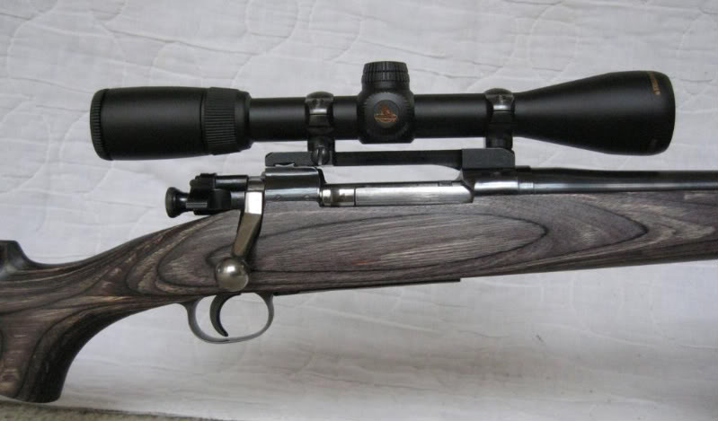

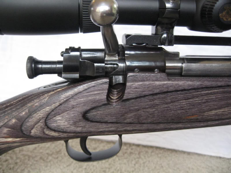

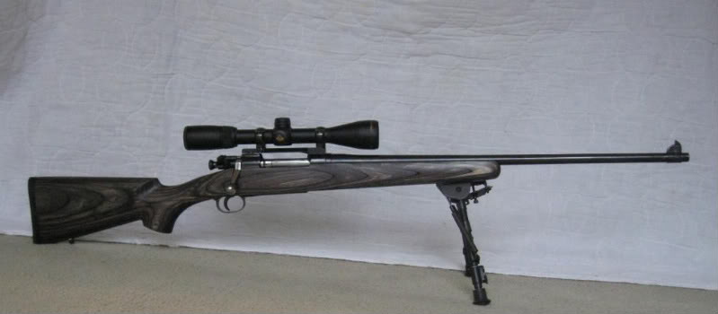

    Restocked and Rescoped my 03A3 Sporter:
    It was already Sporterized when I got it.
    Stock is a Boyds RIA Sporter, Black Pepper Laminate $69
    Any normal person would have sent the Stock back to Boyds, Inletting was
    Not even close <_<
    Since I'm not normal, I deside it would be a good learning experiance to
    attempt to finish the Inletting myself, What the Hay, I got a Dremel
    It was alot of work but it came out really nice.

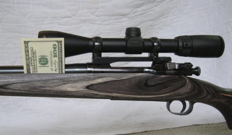

    I Bedded the front & rear of the Action as well as the rear of the Floor Plate
    and free floated the barrel.
    Three coats of Tung oil, one coat of Carnuba wax and one coat of Bore Butter.
    With this being my first real Inletting job, I am pleased with the outcome
    Everything is snug but not over tight.
    Scope is a Nikon 3-9X40BDC
    Now if the Rain would stop, I could get to the range to see how it performs.
    Also later I will Bed the front of the floor plate, or attempt to Pillar Bed it.

    youll find that action bedding will work much better then piller.
    shoot it first,,if aint broke dont fix it.
