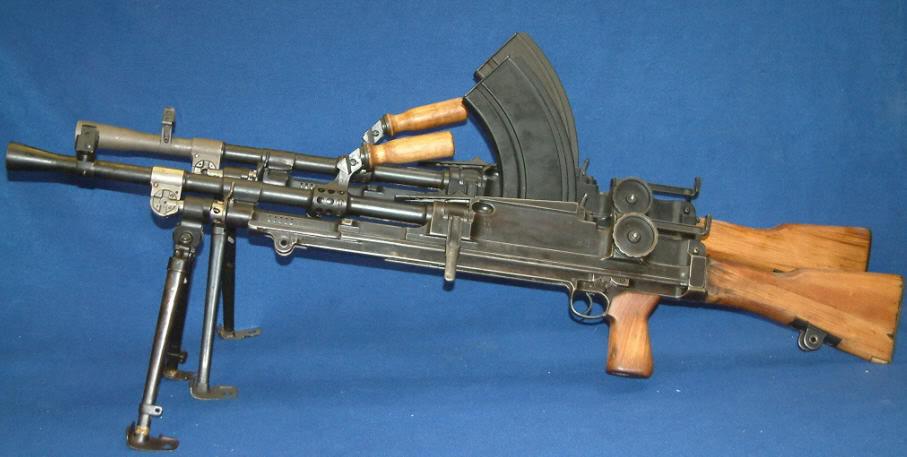

    KG, from the photos, can I assume that during the conversion from 1 to 3/1, that they milled out the recesses in the mag housing too?
    I have seen one with the lightened butt slide too. Any info as to whether this was part of the mod process or was this probably qa Mk3 butt slide that was fitted?
    Apparently, the Indians found that they were sitting on some 18,000 Mk1 barrels so they shortened these to Mk4 lightweight spec as the spare parts stocks for the future.............. just as we did by declaring the Mk1 barrels obsolete and issuing Mk4 barrels to ALL guns, regardless of Mk type

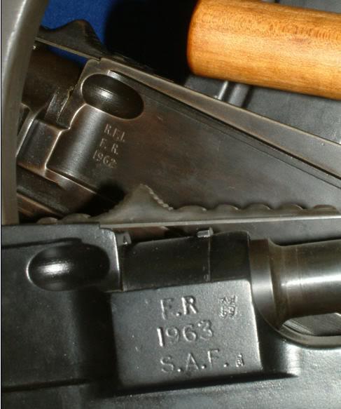

    Yes Peter regarding the recesses.Also one has had the trigger axis pin bushed.
    (Ex Lithgowicon MKI) 63 dated SAF (Small Arms Factory Kanpur)
    (Ex Enfield) 62 dated RFI (Rifle Factory Ishapore)
    Can you give some details on yours grant ?

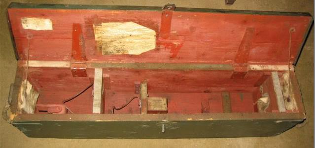

    Grant does your transit chest look like this ?
    ATB Kevin

    Hi Kev, would have got back to you sooner, but was away at the Calgary, Alberta gun show, had a blast!
    Yes, the picture you posted looks exactly like mine, colour and all. Only difference is mine has two sheets of paper on the inside of the lid outlining the proper contents, etc, and a mulitude of stencils on the outside depicting it's origin. I would love to post some pictures, as have some really good ones, how do you guys go about posting your pictures, sorry I am fairly new to posting on this sight?

    Did your transit chest get to Canadaicon from Bombay via Westley Richards in the UKicon ?

    The stencilling on my bren box is exactly like yours so yes, it did get to Canadaicon from Bombay via Westley Richards. I often say it those boxes could only talk.
