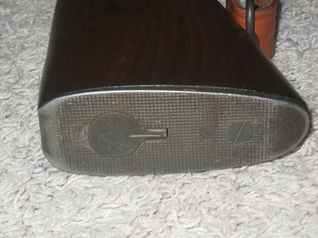

    I just got a 1903 and have some questions. The rifle is Springfield serial 948xxx with a SA '42 barrel. It looks real clean and nice but I have some concerns- the stock has no noticable marks (except what's pictured below) and the bolt has markings that I can not find info on. Those markings are also pictured below. Also, it has a silver colored butt plate that is checkered which I think is not correct- am I right? The bayonet lug has a "H", is that good or bad? Any help / opinions would be appreciated. Thanks

    H on the bayonet lug means it has been hardened, a good thing. Can you post pictures of the butt plate? There were several kinds. Also, the "silver color" can mean 'all the finish is worn off' or it's chrome plated. Again, pictures will help.

    A stamped, checkered buttplate (1903A3) would not be correct for your rifle, but there are also milled, checkered buttplates.

    Wow, thanks for all the responses! I'll post some more pictures of the things requested, anything to help you all help me! I guess I didn't take a picture or it but there is a hole in the receiver on the left side near the front. I figured the lower band did not belong but thanks for the info about the safety and the stock markings.
    Butt Plate

    Your butt plate is a stamped (vs. forged & milled) Remington butt plate from WWII. The finish is worn; a new one was blued.

    I'd change the buttplate and lower band for milled ones. Can't see the stacking swivel enough to tell if it is stamped too, but I'd put a milled one on there. To me, those stamped parts stand out on an '03, and milled, replacements are not expensive.
