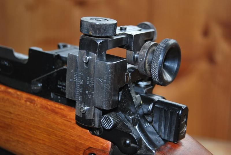

    When I built my Enforcer clone I found that you will not be able to fit both a 5C or 4/47 sight AND a scope as the rear of the sight mount (on the 5c) will be covering the dovetail on the BA mount and you will not be able to get the rings mounted.
    That is why the PH5E/4 sight mounting moves the sight rerwards by about an inch on the Enforcer - which did have both a sight and a scope fitted.
    See how much further back (in relation to the cocking piece) the sight is on a 5E - first pic compared to a 5C second pic
