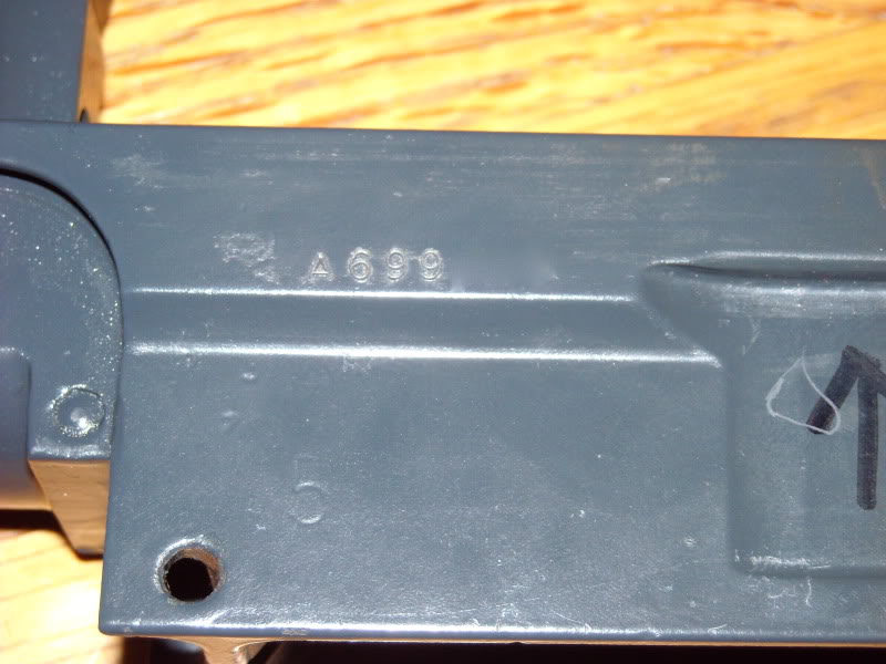

    This is how I made sure the serial number is still visible on the rifle (yes, part is photoshopped out):

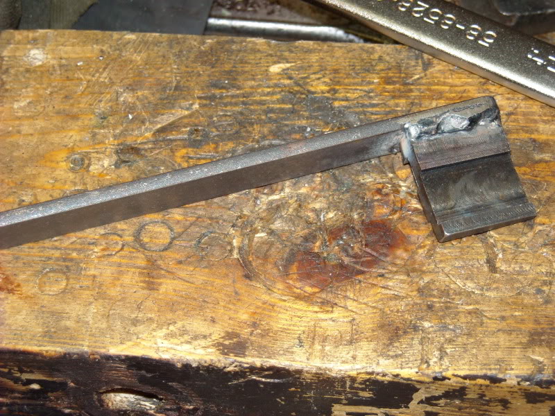

    Next, I cut a piece of 1018 hot-rolled bar stock and milled some lightening cuts into it and MIG welded it to the rear sight wedge:

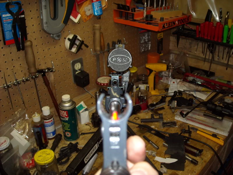

    And here it is mocked up:
    I still have to finish it, probably parkerize it or nitro-carburize it. Not sure yet. It fits nice and tight as it's milled with only a couple thou clearance to the slide and the machining on the bottom fits the spring recess for the rear sight perfectly. The spring tension keeps the deflector in place and it has just enough give to it that it should absorb all the shock of being hit by shells without ever getting near the scope

    Yeah, there's about two M14icon's worth of parts and one and a half VZ58's strewn across the bench at present - should have cleaned it up a little first! LOL.
    As for the deflector, I did dull the edges with a file.
