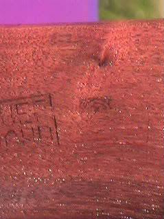

    Below are pictures of a Underwood stock, I picked up from my good buddy Charles in Bhama. We both looked it over closely and thought the CC was missing. We both thought there were 2 wood knots, but the lower one ended up being the CC after treating it. I could even see the rebound of the UEF over GHD stamping. Before you could barely makeout the circled P proof on the bottom of the grip. These AFTER pics were taken with my old Video camera, while the girls were off with the digital camera. Sorry there so small.
    I need fresh pics of all my carbines.
    I'm sure there are plenty of other methods, but I've had good results this way, with no sanding...just buffing down with dry felt pads.
    Here's a before and after picture.
    Keep in mind the AFTER pictures were taken with the stock freshly oiled......
    In direct sunlight.
    FWIW,
    Charlie-painter777
