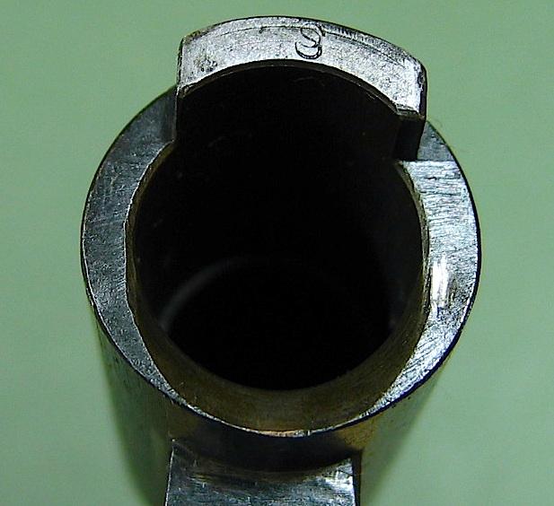

    Early 1916 pistol.

    Johnny, Thanx for posting the pics . I will have to get out the magnifying glass give the barrels another look see.
