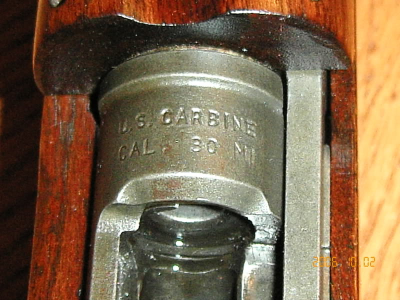

    Mine is Inland 5,061,238 also original, except I put the nicest stock on it I could find at the time. Please take into account that this stock was freshly oiled when these pictures were taken, with flash and overhead lighting.
    Inland 5,061,238
    Barrel dated 3-44 Marked BI on the rear of the Gas Cylinder, Piston marked PI, barrel flat with the Heiroglyphics.

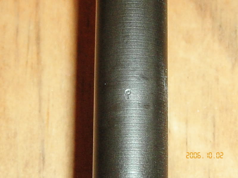

    Small P proof is 6 1/4" from muzzle.

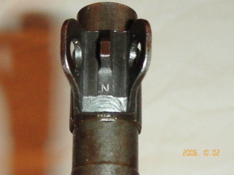

    Frt Sight Type I marked N.
