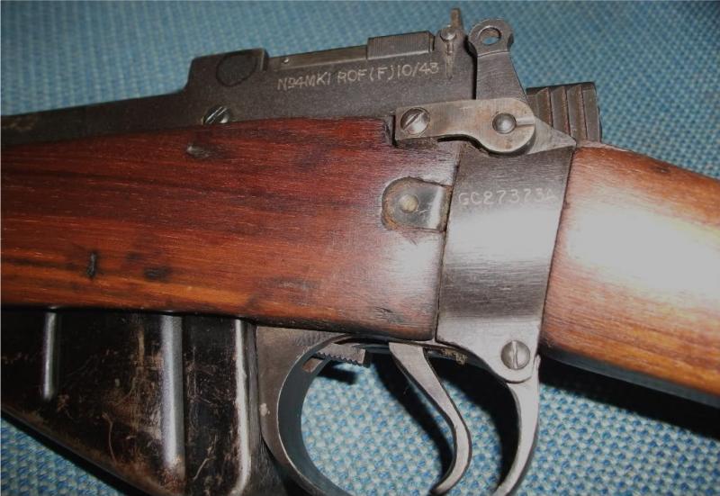

    Example number two:
    Aside from what appears to be a light scrubbing of the woodwork, a crispy fresh Fazackerly. The engraved information is still mostly shiney where the bare steel is exposed.
    Sorry for the bad camera work, this isn't the good one that I get to borrow sometimes.
    Oh, this one has a dated forestock, as mentioned in another thread.

    And for the last of my photo'd Fazackerys today, a painted and import marked Fazackerly that seems to have all the "right" parts, and a dated forestock as well.
    Note the small importer's mark at the very bottom of the butt socket- unfortunately, they aren't usually this discrete.
    Interesting that the striker and striker retaining screw were not painted- not the usual Bubba job, and the paint is pretty darn tough, don't know exactly what to think of it.

    I wonder if the weld on the first one's charger bridge was a field repair? I sure like the front sight base, you don't see them much...
    If you look carefully, they all were welded, apparently from the factory, so I'm guesing that the top one just never had the weld "prettied up". The 6/43 is a little nicer, and the 10/43 only shows as a heat affected zone (localized hardening) in the finish.
    The sight protector's quite nifty, but is likely a completely random installation at some point well past the rifle's mfg. date.
