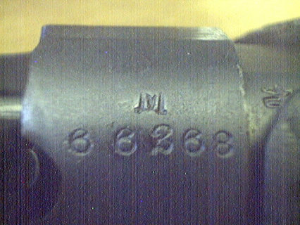

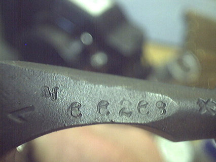

    Dear collectors, I just picked up a 1940 BSA n°1 MkIII* (dispersal). She seems all original and unmessed, but I would like to have your opinion on it. I tryed to provide the pics of every marking that (I think) could be useful to evaluate it. The rifling is virtually as new, I don't think she saw much action.
    Thanks in advance for any given input.

    ziomanno,
    I think you have the original nosecap, the original backsight and the original barrel, but I believe the bolt to be renumbered.
    Take a look at the photos: 1 & 2--your barrel/receiver and your bolt.

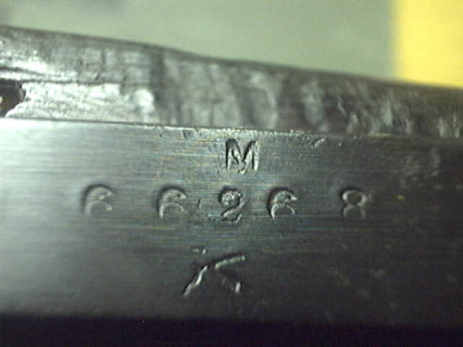

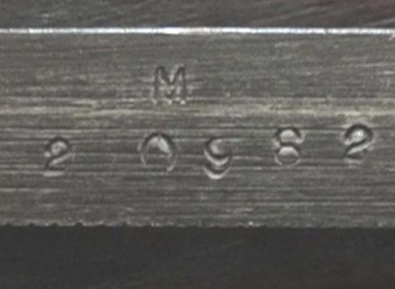

    3 & 4--receiver and bolt from a 1941 "M" series rifle.
    On the 1941, the style of the numbers and letter match between receiver and bolt----the extreme serif on the "6" repeats on both pieces and it's likely the same stamps were used to number them.
    On your 1940, the bolt numbers are noticably not the MoD style and the "M" is sans serif, which is not just a pattern variation, but rather an indication the bolt was replaced outside the MoD system.

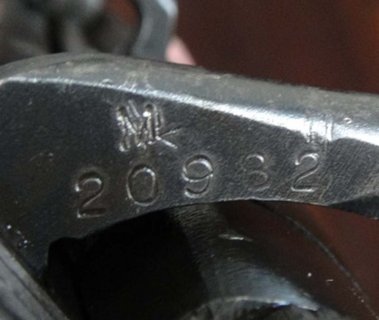

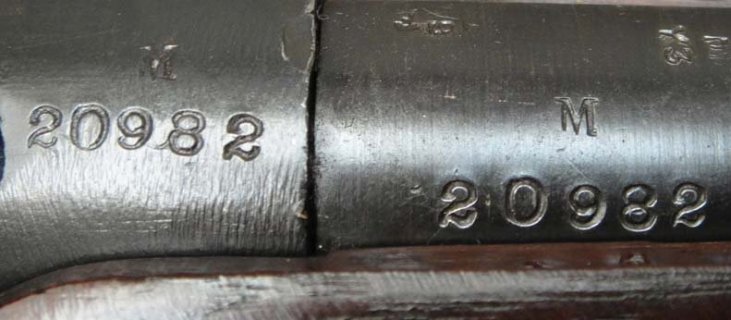

    As regards the sans serif "M" on the backsight----compare photos 5 & 6--your number and the number from the 1941.
    In this case, the plain block "M" is normal.
    It would seem that the backsights were numbered in a separate operation from the rest of the rifle, I have this same "M" on three rifles.
