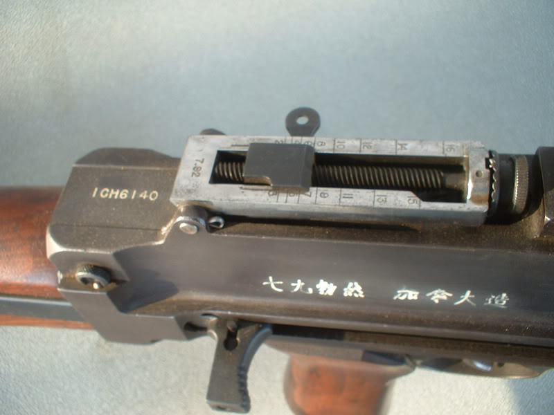

    Here is a photo of mine.
    The stamping of the model mk1M looks pretty amateurish on the one shown on the auction.
