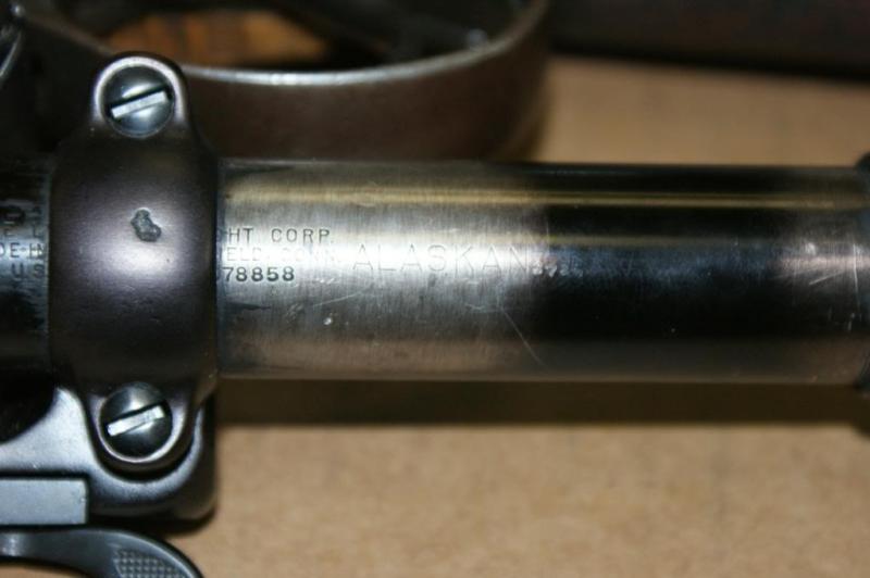

    hi there, I am just wondering if someone could give me an estimate on how much a fake no.4 T LB would possible go for, if it were done with an original Lyman Alaskan scope and mount. Also I have seen two examples of LB's with the alaskan that had the scope painted green. Were all painted? I would appreciate any insite into this. Thanks

    I wouldn't automatically assume that a khaki painted Lyman and rifle is a fake because I know an ex wartime - until the very early 60's RAF Armourer called Stan Payne who had a real McCoy many years ago, before these things were generally known about, certainly in Englandicon. His was spattered with khaki paint and it came from the Dutch Army in Java or Batavia (?) somewhere over there in the 50's. He got it because the RAF and RNZAF in Singapore used to share shipping and rescue patrols with the Dutch air force. He got it off a Dutch Marine when they used to refuel in Java as the Dutch were pulling out of those places. Forgive me if the dates aren't historically dead right........
    Later I learned that these non standard stop-gap No4 snipers were supplied to the Dutch and Belgian armies at the end of the war when they were rebuilding their post war armies. It stands to reason that they would have been taken back to these former colonies. Strangely, he also had a Vickers marked luger from there too that had a bit of history (documented too......) attached to it which before he died, he sold to my friend for £400. And he's still got it!

    Sort of like this one?
    Not mine, but caught a bunch of photos of it a while back. Odd duck it is. Interesting, but was more than I wanted to pay- which I'll have to ask how much it was at the time...if you want me to investigate further.
    Yesterday @ 06:46 AM
    16,651
    05-09-2025
    09:03 AM
    Interesting Lyman telescope JM. It doesn't look like ours at work but looking quickly, I can't seen to click what the subtle differences are!

    same mount, but the cheekpiece was correct. The rifle is a '44 LB that was taken out of grease and is hard to tell from an original other then the serial number. That butt is one odd looking one for sure. If its not to much trouble I would be interested in knowing how much the guy wanted for that. Thanks
