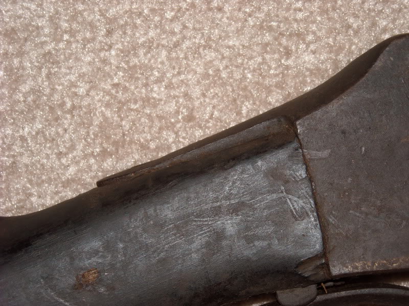

    Small bit of wood missing at the tang, again pretty typical of these from what I've seen.

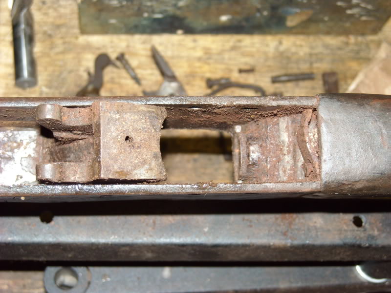

    I next started to take this apart between operations on the EIC musket I was restoring a while back. It's amazing how cruddy the inside of this thing is! The muzzle had 6" of solid mud and stones caked into it and obviously the cleaning rod had been driven back a bit. It makes me wonder if maybe the gun was dropped muzzle-first out of the palace window in Laghan Silekhana while the locals were loading these into crates - lol.
    It still does look though like it will clean up well.

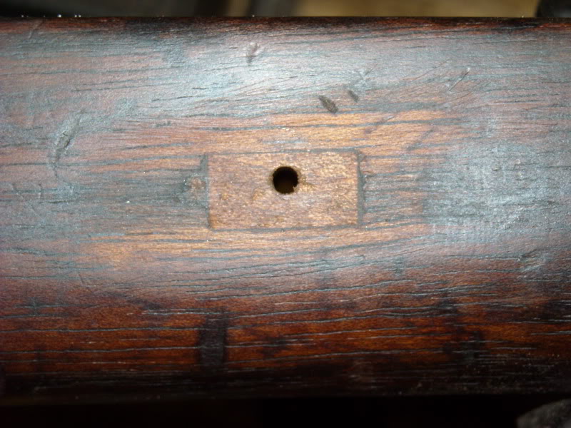

    Here are my forend repairs I had to make. None have been oiled or stained, the wood has been tastefully cleaned and the repairs made and dressed flush - that's all in these pics.
    Left side forestock retaining pin hole:
    The right side of the hole had more damage, so I used a larger rectangular patch:

    Repair along the tang:
    Markings cleaned up. the split is filld with shellac or something and is only 3 or 4mm deep so I'm going to leave it be.

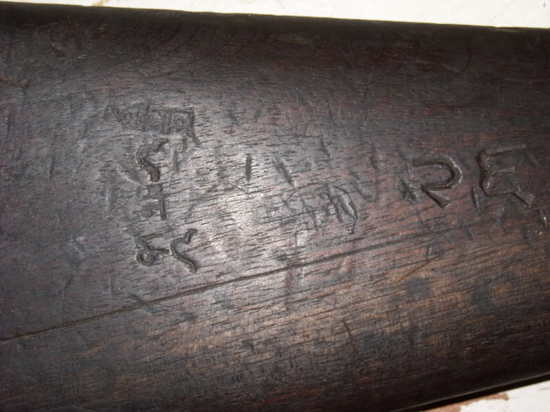

    And finally my receiver markings:
