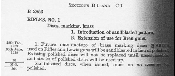

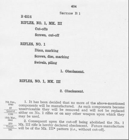

    Ian Skennertons 'The Broad Arrow' p83 makes reference to steel butt discs -
    "Steel butt marking discs were used instead of brass to indicate a Drill Purpose status of an arm (sometimes also encountered with an E.Y. or D.P. marking) but these are often devoid of unit marks"
    Last 2 LoC's on butt discs FWIW
    ATB Kevin

    1923, that's good enough for me! but steel or brass isn't indicative of any status or anything else other that it's steel or brass/supply and demand.
    If I find the page that was referring to in my ancient copy of the ER's, I'll scribble a pencil endorsement to the effect that it came about in the 20's. As a matter of interest, I found the old ER's in a tatty old box. It's a simple typically wartime booklet, soft bue cover and about 1" thick and a good 30 percent relates to unit Armourers. I was going to throw it out until I started to absent mindedly browse through it, but it's full of priceless info, including all about DP rifles
    If you note KG's List of Changes in War Material above, these are the LoC's that are referred to, The B1 relates to the Ordnance category (rifles) then when you see 57 over general over ?195, that is the ACI that authorises it to be published and under that, the 270 over vocab over 181, that is the authority for Ordnance to do their thing and change the Vocabulary of Army Ordnance Stores number - or whatever else the blanket stackers seem to do all day. The 70 over MG over 304 is ther to tell the Ordnance people that it also relates to machine guns on the assumption that in 1940, Lewis guns weren't classed under the C1 Ordnance group
    There, another load of rubbish that you didn't know about
