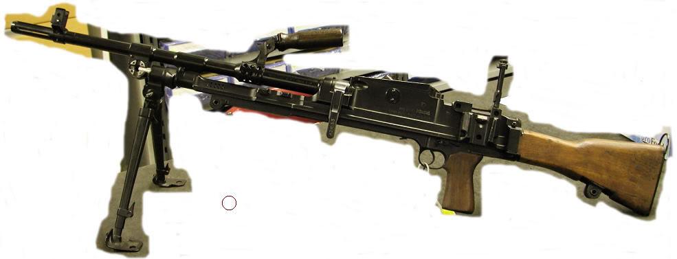

    Legacy Member Kev G's Avatar
    Mar 2008
    03-18-2025 @ 09:32 AM
    564
    05-09-2025
    12:19 AM
    L4A9 with bonus of sling loop to top of butt plate -
    ATB Kevin
