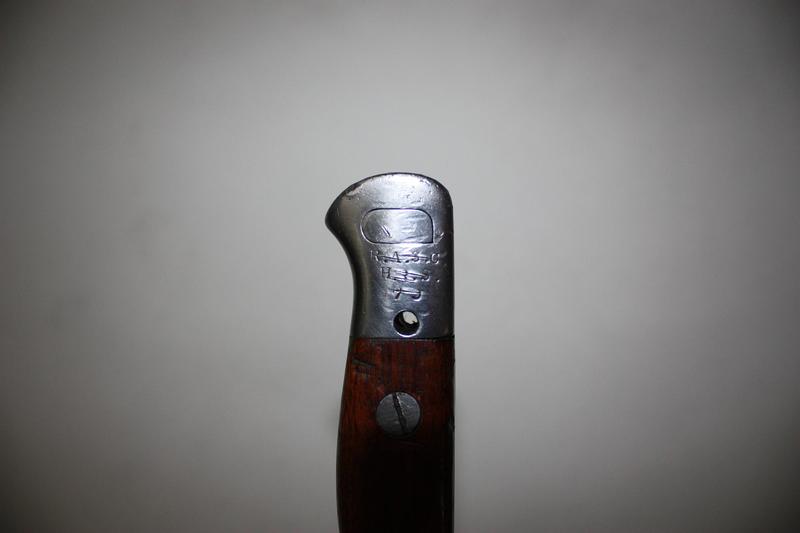

    Toos,
    The "Crown over BM" mark is a military view mark that was applied to all of BSA's commercial rifles. See if there are any other marks on the barrel under the handguard.
    Try and post a photo of the rifle serial number, and also the serial number on the barrel next to it (right side of chamber). Although BSA used many different number ranges for its commercial rifles, a few number sequences are known to relate to certain contracts.
    Since your bayonet is marked to the "RASC", then I would be 99% sure that a previous owner of rifle & bayonet has simply added the "ASC" butt disk in order to create a (badly) matching pair. There would be absolutely zero chance of a rifle and bayonet remaining together when surplussed out - they would have parted company as soon as they were handed in for back-loading by the unit.

    02:30 AM
    The H?S initials on the bayonet must indicate something but while RASC is definately Britishicon Army, those initials don't appear in the 1943 Equipment Regulations (ER's to us.......) that list them. BDLicon has the little booklet copied directly from the ER's if anyone wants to see them.
    From what I can read there, the regimental initials always seem to appear alongside what sub unit it's from. RASC or ASC on its own could be the RASC or ASC, well, anywhere............ It'd usually be RASC 7Co 39 for 7 Company RASC based at, say, Catterick. Just my twopence worth.....
