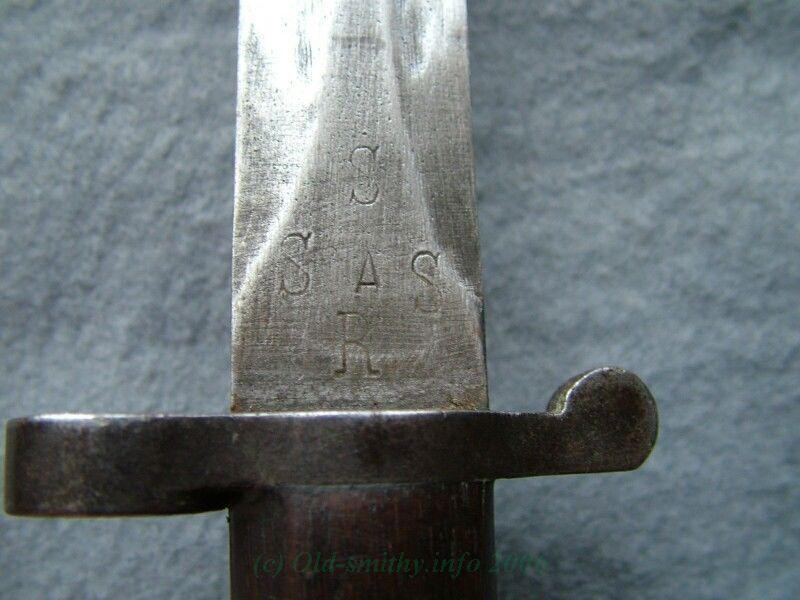

    Never seen pommel marks like these or a painted 88 for that matter, although a lot of their 07's were painted this sand color. The South Africans actually made 88's in WWII so its use is documented
    The above picture is a WWII made 88 made by the South African Railways, probably therefore for their police forces

    Carl, wonderful information, thanks for posting that example. I had never heard that the P88 was made by anyone as late as the Second World War.

    Were the SA police forces issued MLE's or RIC type carbines? Or was the P88 used like a fighting knife?

    Sorry I have no idea on the rifles, it is something i shoudl study up on, but baldes takes all my time and money.
    I also have Scabbards for the 88's made in WWII for the UKicon Navy and one used by the Indians in Kenya marked 41. It seems these rifles lasted a long time, probably in second line service, I believe the NAvy were dock guards (single shot rifles to fight of the Germanicon para's with MP38's
