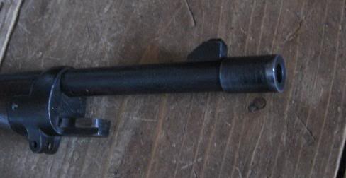

    Early LEC hybrid?
    Quote Originally Posted by rkh View Post
    What would be a fair market value in Canadaicon for a RIC Carbine 1896, the rifle is in very nice shape, complete with sling.
    I'm no expert but I base my knowlege on my observations. I've been on this LEC carbine trip for a while now, I have five of the little buggers in different stages of restoration. So here is my tuppence worth.
    The RIC carbines were conversions of LEC Mk.I* cavalry carbines.
    The conversion consisted of modifying the carbine to accept the P1888 bayonet. To do this, the cavalry nosecap was removed along with the lower barrel band and the forearm was modified by shortening, splicing in wood and reshaping to accept the Rigby style nosecap. The nosecap had a bayonet bar for attaching a Pattern 1888 bayo. The muzzle of the LEC carbine barrel was too small at the muzzle to fit the bayonet's ring without a rattling big clearance gap, so the end of the barrel was bobbed off 1/4 inch and a bushing sweated on to increase the diameter.
    A couple of things about your carbine makes me curious. Firstly you mention it is 1896 dated, which would mean it is likely a Mk.I, not a Mk.I* (Mk.I had a clearing rod, Mk.I* did not, they were obscoleted and deleted from manufacture in 1899). Quite possible that this 1896 one was found and thrown into the mix to be converted, but it seems too early, most that I have seen were based on 1900-1903 carbines. Your stock disc is marked Jan 1905, which is the date when it was put into service with the Irish PoPo, which would make it one of the last batches, so who knows?
    Also the pic shows your barrel to extend past the sight ramp by about an inch and there is no bayonet bushing. This looks like an unmodified LEC barrel, not a converted RIC style.
    So what could you have here is possibly an early unmodified LEC barreled action fitted into an RIC woodset.
    Still a very nice condition carbine with some age to it. If it could only talk!
    Value? Which would be worth more, an early LEC Mk.I or an RIC? I don't think you have either.
