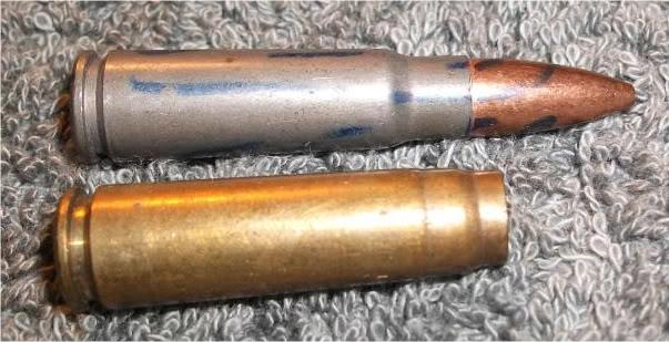

    And I find myself wondering - why do some people get completely twittipated if their headspace is a couple of thou over spec?
    Because they haven't experienced what happens when things ARE out of spec.! Copper/brass cases were adopted in the "way back" because they WILL adapt to a less than perfect fit.
    A handy example:
    VC version of a 7.62x39 in a crudely converted Japaneseicon Type 38 rifle. (Fired case extracted from the rifle is shown on the bottom.) The case only APPEARS longer- optical "delusion"...
    Too tight is generally worse than too loose!
