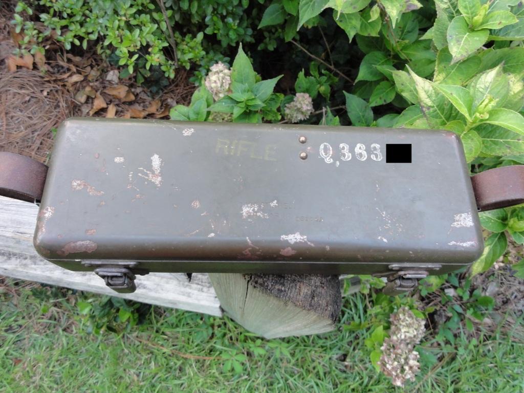

    Here is my No.4T I saved my pennies a long time to get her. She is a 1944 dated BSA Shirley all matching (receiver, bolt, forearm and scope mount) and the scope serial number matches the number on the buttstock. She still has the scope can with her that is matching to the rifle and scope, but no chest. The sling, carry strap for the scope can and the leather lense cover came with her and all apear to be original. The bore is perfect and looks brand new, but I have not taken her apart (I have no plans to) so don't know the barrel date. The scope looks great, but needs some love. The turrets are frozen and the lenses are a little grungy around the edges. Don't know how she shoots..... yet. So can't comment on her accuracy. I think at some point after WW2 she was rebuilt, but she has no FTR mark. Let me know what you think and maybe a ball park price of what you think she is worth.

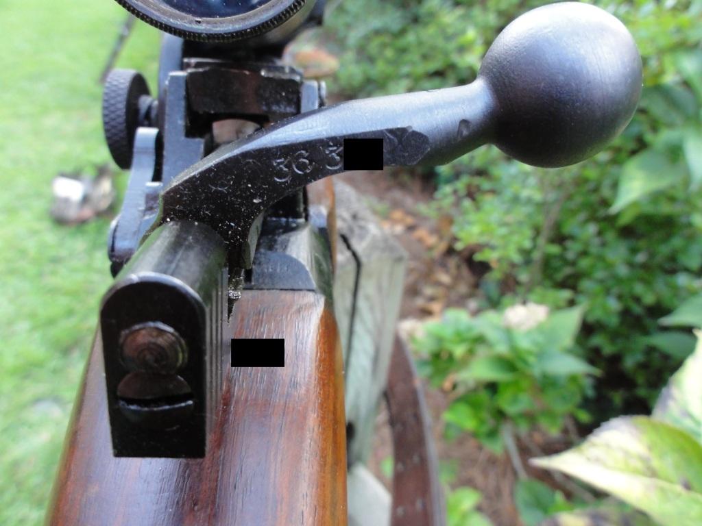

    Hollow bolt knob, is that common on Ts?

    Does anyone know that the label on the left is made from? It looks like it was originally an envelope. The cleaning cloth was in the can when I got her and looks old so I have left it.

    Quote Originally Posted by Sht_LE View Post
    1. Hollow bolt knob, is that common on Ts?
    2. No import stamp on her but she does have an export stamp. Any way to date this?
    3. Does anyone know that the label on the left is made from? It looks like it was originally an envelope.
    4. Alloy butt plate. Seems like most Ts I have seen have brass.
    1. Common (I think) on BSAs.
    2. They are English Proof Marks not export marks. (We don't have 'em.) London post-1954 but not recent, because we have moved from tons [] Inch to Bar.
    3. It's Reuse of Envelopes label. You close the open envelope with it so that it can be used again. Having said that, because those labels had an "On His (Her) Majesty's Service" device (Where do you think that Ian Fleming got the book title from?) on them, they were commonly used in lieu of Postage Stamps and because they were sticky, they were commonly used as general purpose labels.
    4. Again Common (I think) on BSAs.

    I'd agree with Beerhunter re the bolt knob. Indeed I'd go as far as to say it is the norm on BSA rifles & if anyone has a T set up on a BSA made rifle & the bolt knob is not hollowed then they'd better have a very close look at the numbering on it as the bolt is likely to be a replacement (not that that matters if done properly, though anathema to some collectors).
