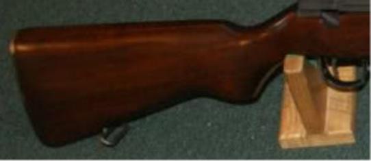

    Unless you do! Found one this morning. Photos coming, but no I.D. marks left. I got it about 25 years ago out of a huge pile of ratty old stocks at a military surplus store's storage building. $5 or $15.

    Photos:
    The toe's pretty degraded, but it's not odd otherwise.
    The front's not as bad as it looks here, but again, it's just something that was bought at random.

    Do you think it was factory (two diameter top screw hole) or rebuild. Sometimes a rebuild facility would drill out the top screw hole and not install the plug. There are variations of the early M14icon stock concerning the top screw hole. Your stock photos look just like the early M14 stock. They were using some different variations of the M1 buttplate including aluminum for testing and the two diameter size top screw hole could be related ?

    I don't see any sign of a plug or repair there, but it's pretty crusty.
    The stock has been mated to a rifle, as the wood is compressed on the belly, but it's too big to close the trigger guard on any of the actions tried so far. Otherwise, it would either be gone or in active use. Good "full figured" stock.
    An aluminum buttplate would be great! But then there would have to be another rifle to go with it.
