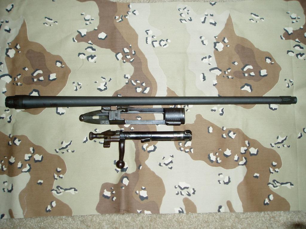

    I called my smith a few days later about restoring it to shooting condition, and he mentioned that he had a brand new Smith-Corona barrel.
    The barreled action was taken over and the old barrel removed. The barrel weld was very small and mostly on the barrel. No discoloration from the welding was evident on the receiver.

    After removing old barrel. New barrel pictured. Note area of weld on receiver is not discolored.
