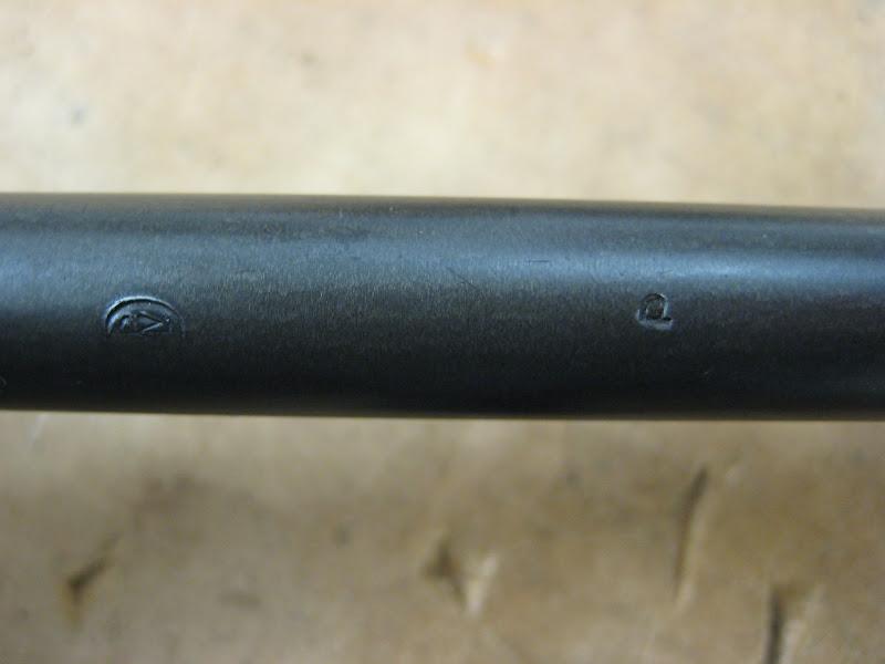

    barrel proof
    here is pic showing the winch proof and the short or fat P that qhmc used
    ---------- Post added at 01:15 PM ---------- Previous post was at 01:11 PM ----------
    the second hole which is clearly releasing the gas if was continued would have come out front of gas cylinder if it had continued at angle it was at. Someone clearly stopped. The normal hole just has a lot of carbon build up, they are same size.
