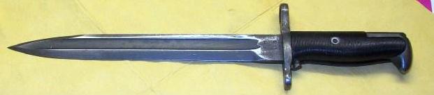

    As for my 1944 Garand I found this bayo at a reasonable price.
    It seems a M1942 being cut to 10" with U.F.H. + U.O.S + 1942 printed over.
    I guess it should come with a M3 cut scabbard or with an M7 one.

    That example will suffice because it has all the features. 1942 date, modified for the new M1icon. Remarked accordingly. An M3 scabbard would be nice...

    I dont' know yet if this bayo has a M3 modified or a M7 scabbard.
    Will check in 2 weeks time when the dealer will come here to show me the item before selling.
    It's price is 120 € , about $150, I know it is expensive if compared to prices in USAicon, but I am in Italyicon and must be happy with that.

    This bayonet would also work for your 1954 rifle. The USMC was still using any 10" bayonet in 1954. It was in 1955 or 1956 that they switched to the M5 type. Of course, your rifle would have spent most of its active service period with the M5A1 so that is the one I would go with. As Jim said. the 10" pictured will work fine with a 1944 M1 rifle.

    Next week I should buy the bayo in the photo.
