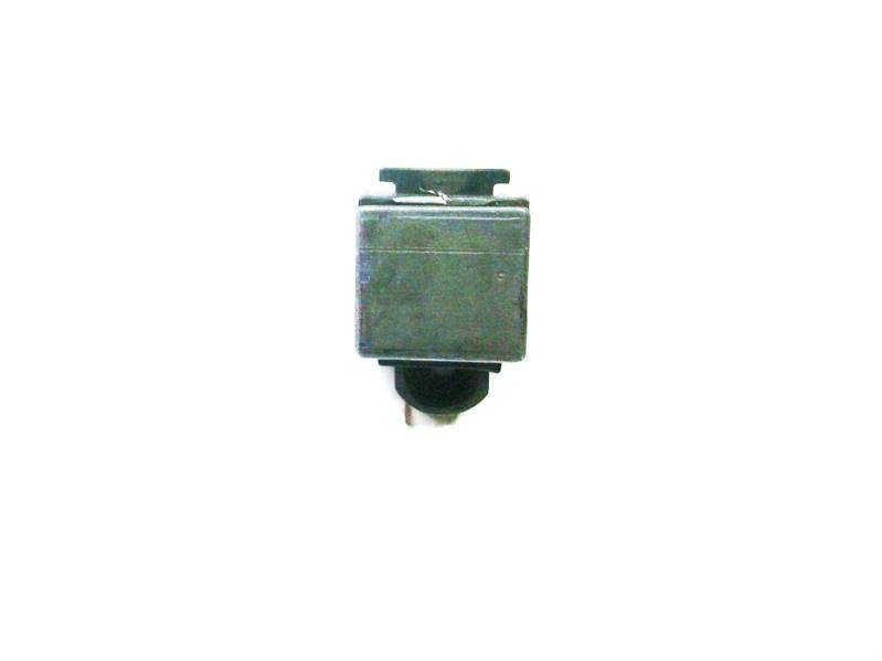

    Did happen to see this advertised as a WRA frt sight that sold for $92.66.
    Has anyone ever seen a WRA frt sight with this type ridge?
    WRA Front sight,
    M1 Carbine WinchesterType 1 Front Sight unmarked | eBay

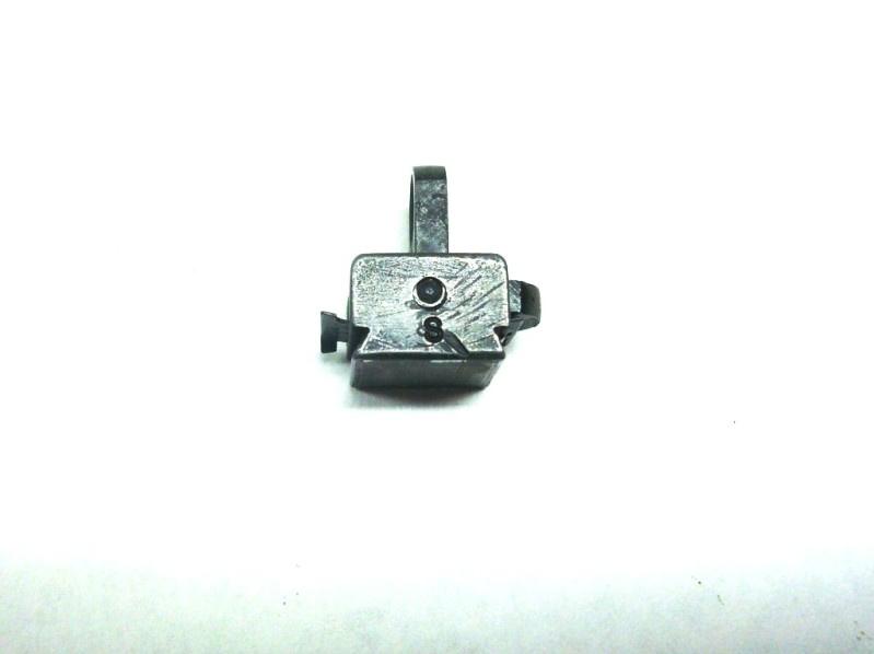

    Here he offers a .U. marked flip sight. The .U. is marked up side down on the tall leaf, same as the few I own. But look closely and you'll see a S stamped over another style S. Also see that small familiar hole on the bottom of the base you'd find on a Iver johnson style flip sight. To the sellers credit he does state to decide before you bid if this is a original part.
    .U. Flip Sight,
    eBay - New & used electronics, cars, apparel, collectibles, sporting goods & more at low prices
    Your thoughts?

    It looks as though the "S" was stamped after the dings. Something causes me to take issue with this sight

    When I blow the picture up of the Ebay flip, I can clearly see a new smaller S stamped over another different style S.
    If that leaf was/is real I'd buy, trash the base and install on a .U. base I have here.

    I'm not to sure all the other stuff he has is legit either. That re-stamped "S" speaks volumes.
    Charlie, I'm by no means an expert on these type I sights but......

    I've bought a couple of things from that seller and they were good. HOWEVER, then I saw a flip sight, but in fairness he has a disclaimer that he couldn't swear it to be USGI. The other items I've seen that were GI he said they were absolutely GI. Based on that, it's not GI to me.

    Charlie, that Win sight is exactly like my 5.6 Win
    This photo doesn't show it well, but the machining marks are the same.

    Dave,
    I printed off a pic of that WRA frt sight in the past auction. When holding a known WRA sight up to it, I can clearly see the shape of the outer ears match.
    Still shocked it pulled in $92.
    Thx,
    Charlie
