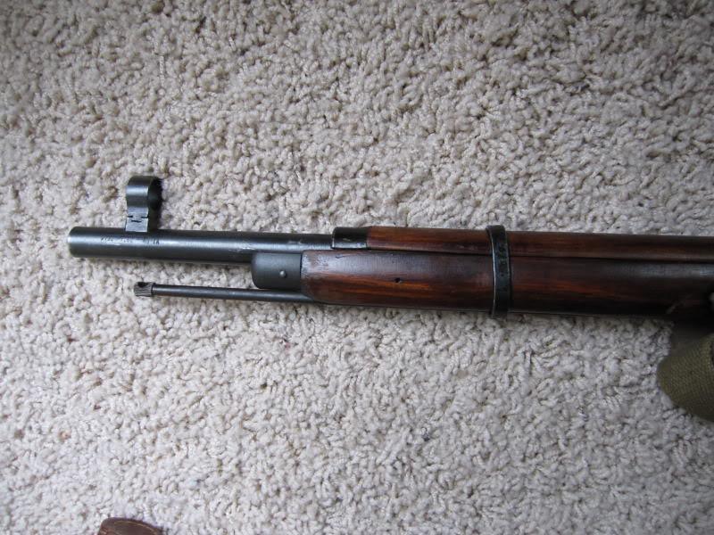

    hrm I all ready had the mount installed... hope I didn't destroy something...
    I'll have a look at the ukrainian repro, I'm curious to see how this shoots.
    also is the tolerance on the forend normal? I thought there was meant to be a gap, I was about to cork (found an article) it when I noticed this

    All 3 of my genuine PU snipers ('43, '44 Izhevsk, '44 Tula) have a mismatch in length of the top handguard to stock. The '44 Izhevsk has a bigger gap than the other two, but I don't think there is any signifigance.
    Here's the '44 Izhevsk...
