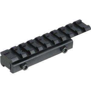

    ... though, on either one, if you remove the rear sight base, you will find a 3/8" dovetail that will accept airgun 'scope mounts and, properly mounted, will hold fine. I recommend the this:
    UTG 11mm to Weaver Adapter, Adjustable: Amazon.com: Sports Outdoors
    That said, I'm Smith-Sights and recommend you stay with open sights if at all possible, if you have a 91/30 or post-1930 carbine!
