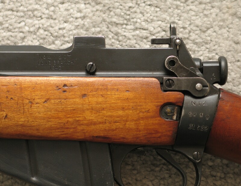

    Is this the correct Longbranch safety?
    I found this online, please educate me, I thought the LB safety was "fishtail" This rifle is a 1942 Long Branch No 4 Mk I*, did the fish tail come later in production?

    Quote Originally Posted by Oatmeal Savage View Post
    I believe the fishtail safeties came later, like 49-50 or so.(my 49 has one) I've seen wartime LB's like in that picture...
    Someone else may know better though.

    There were at least three patterns of safeties made at LB. I agree that the slipper style was the last version.

    Picture is of a longbranch with the proper LB marked early safety about 1942
    sorry I dont have a better picture
