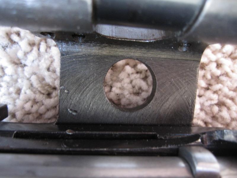

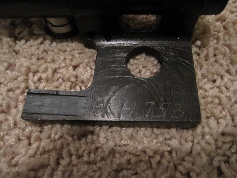

    Original WWII scope mounts are fairly easy to identify by their machining marks. Here's some examples:
    Izevsk mount has big circles like this:
    Tula has smaller circles like this:
    If I were you, I would not buy one at a gun show. Your better off buying one online from a known source. RGUNS sells the real deal for $800. There was also a recent batch of imports from that several vendors are selling, including AIM Surplus, Classic Arms, Wideners, Royal Tiger, etc. These are all in the $600 range and have been "authenticated" by the collector communities online.
