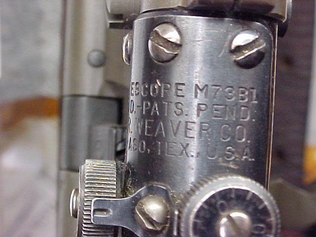

    The scope is a 330C, but it really doesn't matter whether or not the engraving was done by the US military. The model scope is determined by the manufacturer. This is a M73B1:
    The person who did the sporterizing had access to good stuff. The bolt (which has been arsenal refinished) is from a 1903A4, probably worth $200-300. The 3/4" parkerized one-piece USGI rings are worth $200-300, & the Redfield USGI base another $100. And, that may be a M1907 sling.
    Sporterized 1903's are usually worth $200-300, but yours is worth way more than that in parts alone.
