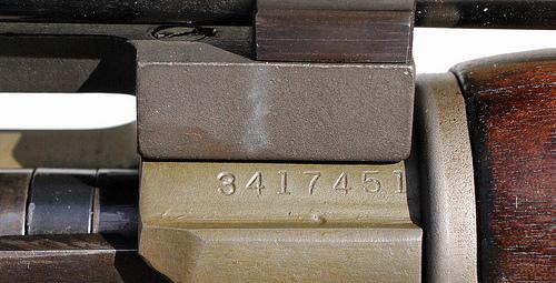

    Here is a photo of the rcvr serial marking.
    Jim, there is no shim under the scope mount. I should also make it clear that my concern about the front sight area was not the dark "gook" in the channel, that was dried grease or cosmo and cleaned right out. My concern was some slight compression marking (abrasion shininess if that makes sense?) in the park where a front sight would have been installed.

    I finally had a lightbulb come on over my head Jim. I was looking for shims between the mount and rings, duh! There appears to be not one but two shims under the front mount between mount and receiver, but I don't get where they would be "staked"?

    The armorers used several different thickness shims to get sufficient elevation in the front.
    The 2 screws holding the mount to the receiver should have a staking punch depression on the edge of each screw.

    This is what is meant by "staked". You can see how a punch was used to strike the mounting screw and the mount which in effect locks them together.

    Note the punch mark on the top of the mount near the LEFT adjustment screw. This means that, if you want to remove the scope, remove only the RIGHT adjustment screw.
