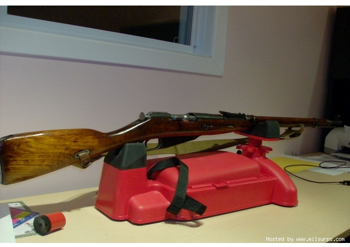

    Pictures of the 91/30
    Well I don't like shellac, never really did (it's a type of bug poo, isn't it? Or bug puke? Anyways a type of secretion).
    Nevertheless, since my M91/30 is dated 1942 and was made at the Izhevsk arsenal, shellac it was.
    That stuff works great on leveled surfaces. Like a table. but a rifle stock... I find it difficult to even out the coat.
    Now, I didn't really play with the dilution; I didn't mix my own; I used off-the-shelf premixed shellac. Still, I'm somewhat happy with the result. I may give the stock another two or three coats later, we'll see.
    That rifle is a pretty average M91/30. I like the fact that the 1942 date explains the rough surfaces on the receiver.
    I'll be shooting with it tomorrow, can't wait to give it a good try.
    I'll try to take better pictures in natural light.
    Lou

    Looks good, lou.
    Getting an even finish on a Sovieticon MN, especially a '42 wouldn't really concern me. It was probably originally applied by dunking the whole stock or with a great big brush. If it was too even, it would be out of character for the rifle.
    I had a post-war Finn M91 and the shellac wasn't even on it either. It had drips and bubbles.

    Thanks Stevo!
    Yeah, it does make sense. Knowing how fast they had to ship these through the door, they likely didn't have the time to try to get that perfect, smooth finish so that the soldiers could use the rifle's butt as a mirror.
    Ha, there, how about "I made the finish look a bit rough to be more historically accurate"... :P
    Lou

    There is no correct shellac colour, it was luck of the draw as to what the tint was. Most common was the orange & red tint but I have seen original rifles ( post was refurb) with an almost clear shellac. The only thing that make your rifle look a bit off is it too shiny. Use some steel 0000 steel wool to knock down the shine. Now the next time someone say's you bubba'ed it, explain to the nice folks(as you pound them with the butt end of said rifle) you didn't stain, sand, cut, polish, BLOicon, or turn down the the bolt so you ain't no bubba.

    Thanks Desporterizer. And I agree with you about the "shine". I should dull the finish a little.

    IMO, lots of "shine" isn't that atypical. The refurb M38 and M44s I bought from TradEx a couple of years ago are pretty shiny.
