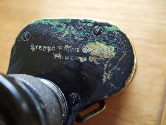

    I also saw a pair of US type made by Lomb and Bausch(?) where collimation was achieved by adjusting the prisms........ Phew, what a job!
    Its a case of needing two pairs of hands, bit like setting up a Mk1 No32 scope, one of the first pairs I had to re cement the objective lens, but out of all the different makes I,ve had, the Ross pair (see pics) have to win for quality, lens, overall picture etc, pics below B&L, Ross and a few others in the collection, all from ebay, type in the correct words in the search and a good quality pair of binoculars can be had for peanuts, broken ones (or supposed broken) are even cheaper.
    The Ross in with a 1916 case,
