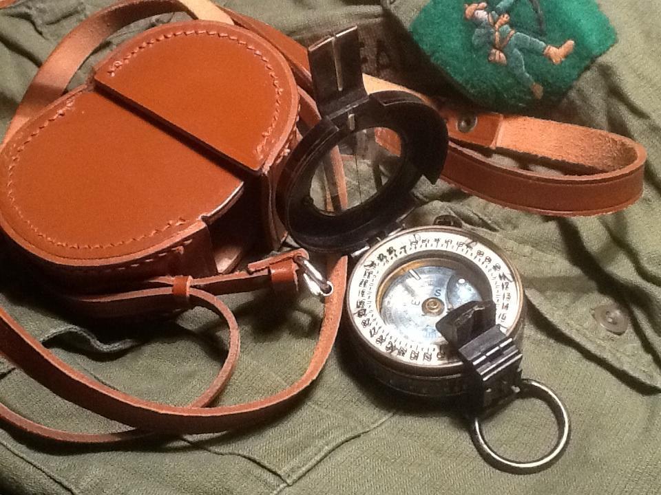

    Here's a compass porn pic I was asked to take for another forum.
    If its upside down, your probably using a iPad. I don't know why.

    That compass and the leather case don't look deep enough to be the UKicon Military type. Ours were about 1.25" deep including the prism cover (the bit fixed to the lid that covers the prism assembly when closed down.....) Or is it camera angle distortion?

    Its the angle as it's as thick as all the otherMk IIIs I've seen and its a perfect fit in the case, not too tight but no rattling about. This case has no markings on it at all hence the conclusion its a modern civy job. It has a roll buckle to close the case and to adjust the strap lenght. but the latest ones have press stud closure.
