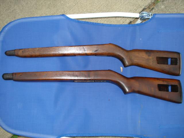

    UEF M-U stock (Type III above) WRA stock (Type III bottom):
    Notice both the Marlin made and WRA stocks have thick wrists. Unless sanded this is associated to WRA stocks but other makers can be very similar.

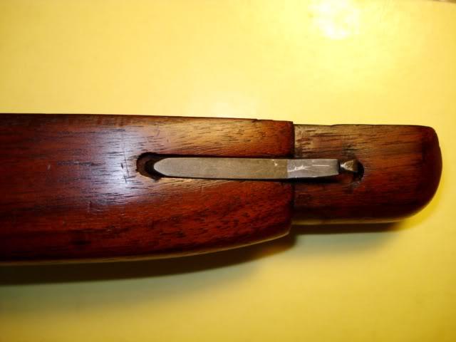

    The outer barrel channel or nose of the WRA stocks are usually a little longer and bulky:

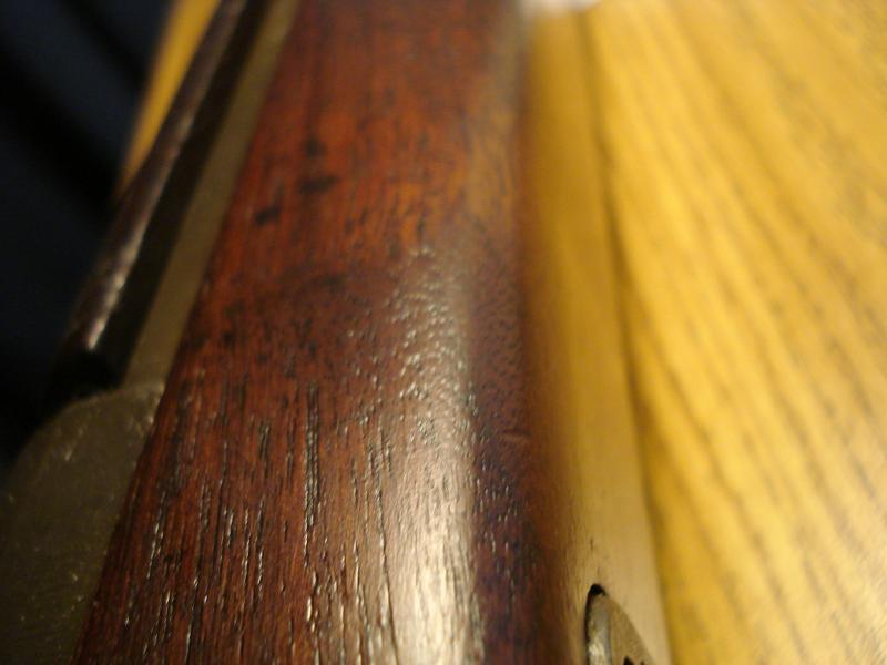

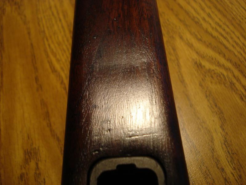

    Look for..... But easier to feel for vice like impressions in the stock just forward of the inner wood bridge, forward of the magwell opening. Unless sanded away you'll feel these shallow impressions both on the 2 sides and the bottom:
    I can feel this one but can't get a good picture. Hopefully you'll get the idea of the area to check...... both sides and bottom:
