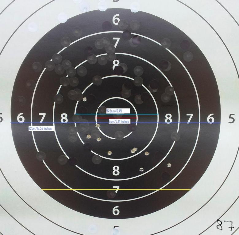

    but I find it only benefits when other elements are in place (posture / natural - aligned position and aim point etc)
    I do agree, a good sling is the cherry on the cake, it is not the starting point for shooting. Before a mentor tells me to use a 1907, I was using the regular Lee Enfield web sling that was fitting my n°4 since 1944. I was at 175 pts/200 on a Frenchicon target for service rifle competition at 200m/218 yards.
    Since I swap to the 1907, my last score was 182/200. By changing the sling, I gained 7 points, the rest is as described, position, breath under control. But, to me, this is not the one that has to go with my Lee, that's why I've ask for a different solution, a bit more Britishicon style, to respect my rifle.
    The yellow line shows my aiming point, I have to zeroed again because I changed the powder for this shot.
    Enclosed a training target, I did better after, the bullseye is 6.49 inches width, the "9" is 6.49 inches width and the black zone is 16.53 inches width.
    My Lee Enfield is equipped with the MkII backsight and is 100% unchanged since 1944.
