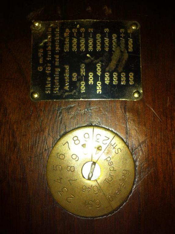

    does it have range plate like this one on my 1917 CG M96?
