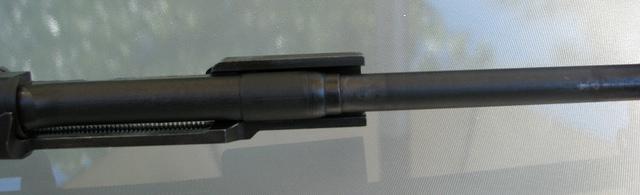

    .U. is the mark. My NPM has an I cut Inland stock with the .U. on the left side wrist. Here is original Inland finish:

    Dave, How can you tell it is the "original Inland finish"? I've recently become very interested in when the major parts were finished during the manufacturing/assembly process and the evidence for such. Could you post a picture of your receiver's proof mark (just in front of the rear sight)?

    If you look at the top photo posted earlier
    You will clearly see where the finish is different top side vs bottom. That line is where Inland sand blasted the top portion of their receivers. The bottom portion was not sandblasted because it was hidden by the stock. Inland receivers were also finished as an assembled unit. Below is a photo of the same Inland. Notice the difference of the finish in front of the gas cylinder? This is where the band was placed when the carbine was finished as an assembled unit. When the sandblast line and band shadow are present, the finish is the original factory applied parking.
