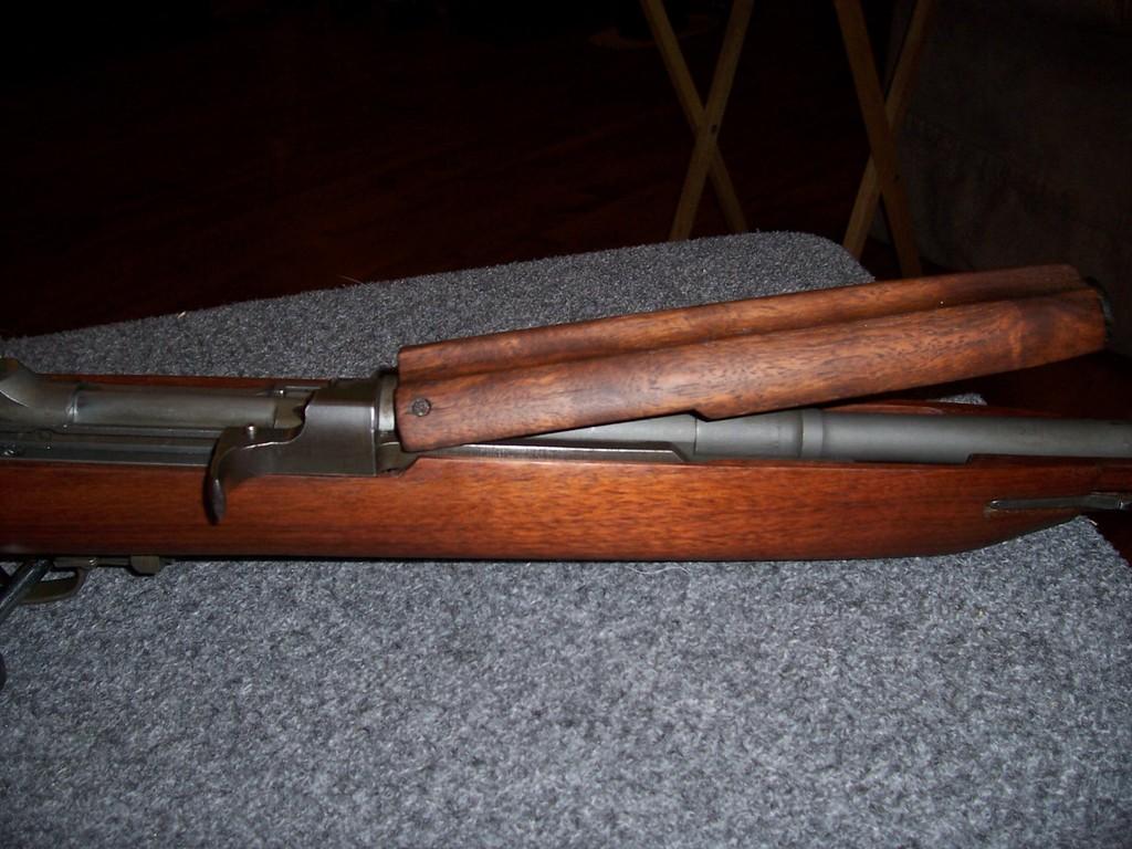

    I picked up a high wood stock out of a barrel of old stocks, It looked nice but when I put my action in it sits too deep, recoil block is tight and works well in old stock, the only problem is when installing hand guard the metal lip is to high, You can put it in if you pick the action up about 1/16 of an inch, barrel is clear of the channel,,will it hurt to have the action suspended between the block and the hand guard ?

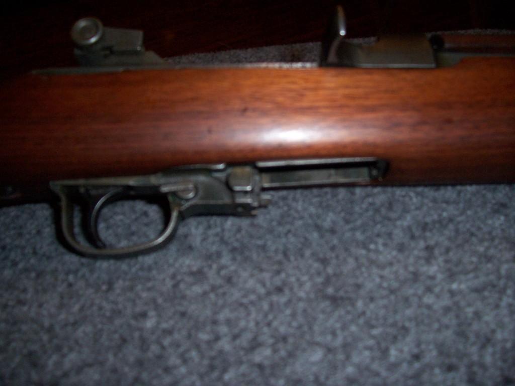

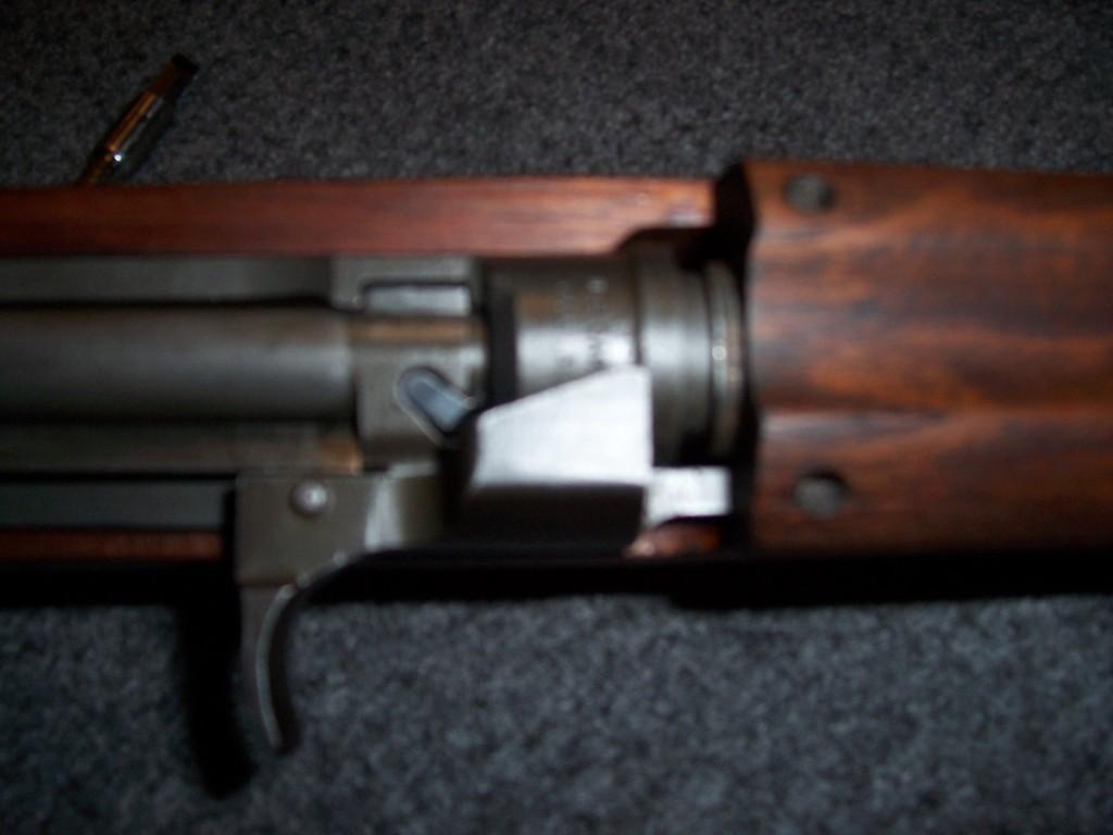

    I was up at a pawn/gun shop in North Arkansas last weekend, He had several barrels of old gun stocks with a sign that said ur choice $30. I found an I cut high wood stock with a "ROCK OLA" marked recoil plate, "RMC" in the sling well and I think correct butt plate and He gave a 2 rivet RMC marked top piece to go with it As my Rock-ola sits in Winchester wood I bought it. even if its fake it was cheap ,,,action fits into it perfect except where the metal lip on the top wood hand guard should slide into the action,,they are the same height,,you have to lift the barrel a 1/16 to get it in or put it in at an angle but you still lift it when you bring it down flush..I have tried 3 recoil plates and 2 different top wood and they all fit the same.. I guess I could just bend the metal lip down a little on the top wood but did not wish to break the 2 rivets. the barrel sits in the channel about where it should,,the mag well looks about right,,just the top wood dont fit

    Okay, so you can't get the hand guard to fit where it locks to the receiver. The sheet-metal tab is adjustable by bending. Previously is was flared up to fit a certain carbine. Now you have to de-flare it to fit yours. At least, that's what I think after seeing the pics. You want to use a tool on the tab without teeth so you don't scratch/tear up the soft tab. You could try peening it from underneath - turn it over, rest the tab on a hard edge and lightly straighten the flare with a ball-peen hammer

    One last question,,That handguard was given to me ,,Its marked RMC inside and pretty well wore but its a different kind of wood,,the Gentleman that gave it to me said it was Cherry,,can you tell from the pictures,,

    Looks like walnut to me.

    Cherry wood is not red. It can be stained any color. I think I've heard that story before and am not sure about it. Looks like an early Walnut guard to me - they were using figured Walnut in the early days of production.
