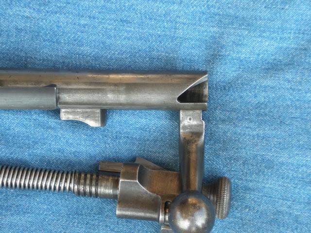

    1. The bolt is marked with a punch mark on the bottom of the bolt handle root which Poyer says is Rock Island's mark. Also, the bolt body shows no narrowing around the the safety lug which, according to Poyer, make it an '03 bolt, not an '03-A3. And the cocking piece know is the '03 pattern.

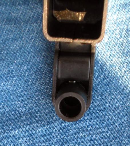

    2. The trigger guard has a "pad" (sheet metal folded into an inverted U) between the front of the magazine box and the front guard screw hole. Poyer says this is a Remington '03-A4 design.

    SC used padded trigger guards as well as Remington. Look at the relief cut on the their side of the front trigger guard hole. Curved is SC, straight across its Rem.
    Bolt does looks like an early straight handle 1903.

    It's curved! It's curved! Supercub, you just made my day. I guess it is one of Poyer's errors. A question: where did you get that info? Clearly, I need a better reference source.

    Even though the bolt is "curved" downward, as in bent, it is still what is called an early straight handled bolt. The late-1903 and all 1903-A3 bolt handles were also curved downward, but are 'swept' rearward, as well.

    I tend to take Poyer with a grain of salt. I agree about the trigger guard - it is a "late" characteristic, not a M1903A4.
    The punch mark on the bolt as a RIA is news to me.
