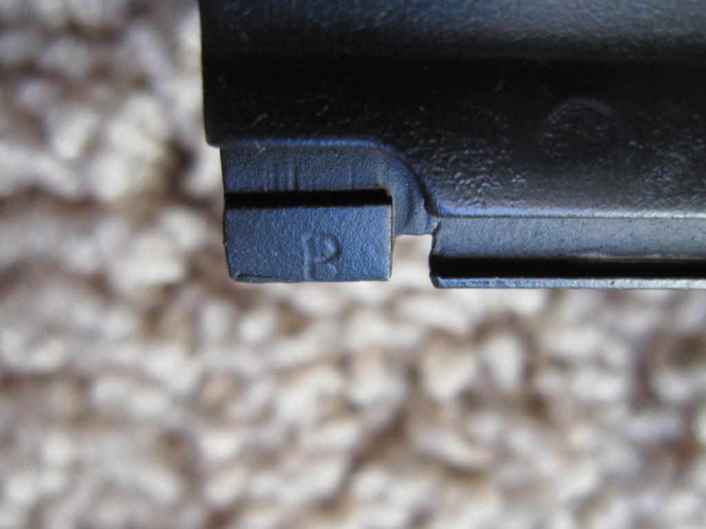

    Many years ago while looking for optic choices for my Austrian Stg58, I found and purchased a dust cover mount for the Trilux SUIT. It had the tabs on it, which I trimmed to fit my Stg58. The only markings on the cover is what appears to be a "B" on the right side tab:
    Can anyone tell me the manufacturer?

    B = BSA

    I don't think that this could have been a military mount, with the use of aluminum rivets. It didn't last very long at all before they worked loose from recoil. I guess this means that at least some of the cheap reproductions have a "B" mark.
    Does anyone have any detailed photos of a known BSA made cover/mount? Photos of the underside and any markings?

    Here are pics of the covers I have;
    Attachment 66634Attachment 66635Attachment 66636Attachment 66637Attachment 66638Attachment 66639
    The first two appear to have been made by BSA, the last by Enfield.
    The 'B' on the plain 'BSA' cover has a crude electro-pencil engraved B. The SUIT mount top cover 'B' looks like a stamp of some sort. The Enfield stamp is inside the cover near the front.
    Could SUIT sight mounts have been fitted later to old-stock BSA top covers?

    Looks like Charlie has the answer. Seems like the mount makers were supplied with covers upon which to mount their mounts.
    Just noticed that I have one marked P-H internally similar to the DE marked example. Who'd have thought that?
